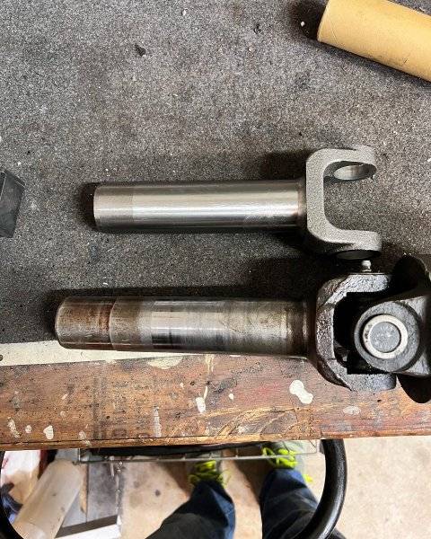

The length is fine. Same shaft I’ve had in the car. Only thing I recently did was change the yolk because the original yolk was work and kept leaking. The new yolk is shorter but not by much.

No play there. The trans was rebuilt about 250 miles ago and the yolk just changed a couple weeks ago.
