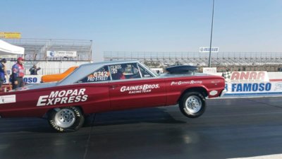

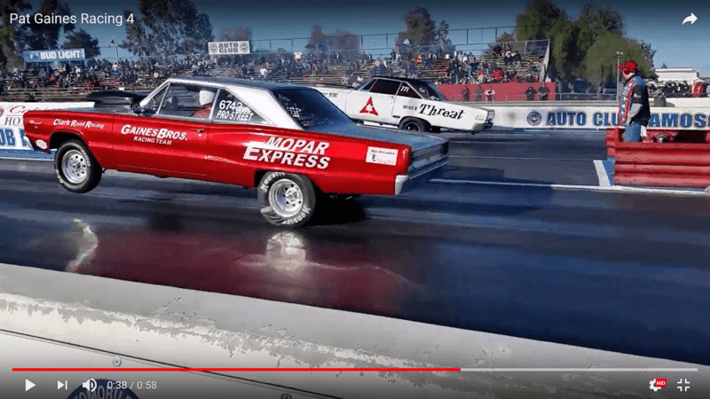

In the correct trim (which I am going back to) the car pulls the front wheels about 12" to 14" for about 20 feet.
