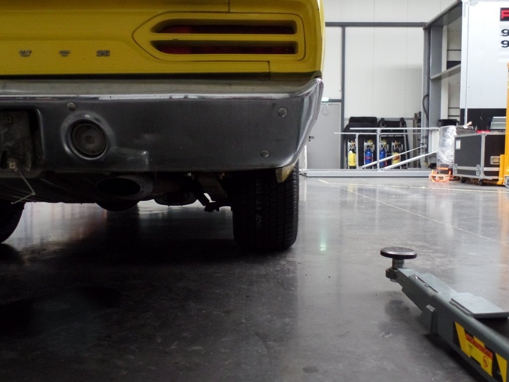

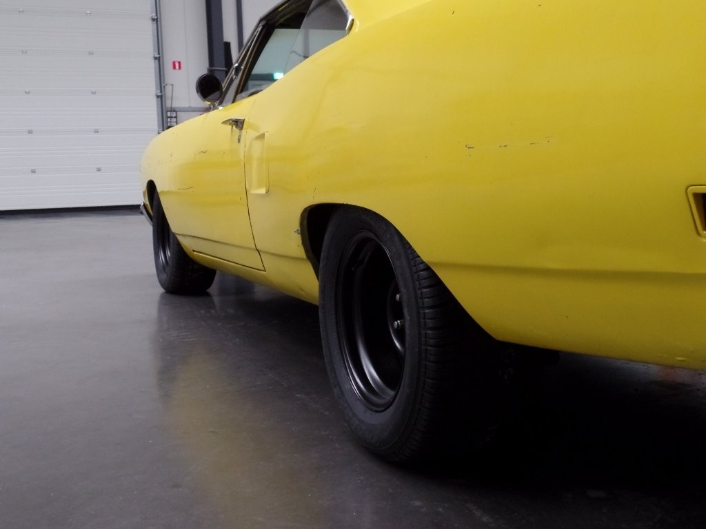

picture taken from other angle.
(50 would be the series)...but I get what you mean doesn't seem fat enough to be a 295..I do like how it sits in the fenderwell though! That's why I'm thinking 295/55, will have some girth but be about 28" tall....

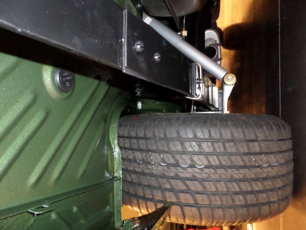

here a picture from under the car, distance between leaf spring and distance between fender lip.
leafs or fender? How close are they to the leafs?
Neither. They would rub on the "bulge" in the inner wheel wells (outboard side). Some people have worked to remove these bulges to accept larger tires. Note that I have stock and original Hemi suspension, stock wheel wells and stock body lines etc. There are no rear suspension modifications of any kind.
Good luck with your choices, and I hope this helps. Let me know if you need more pictures.
