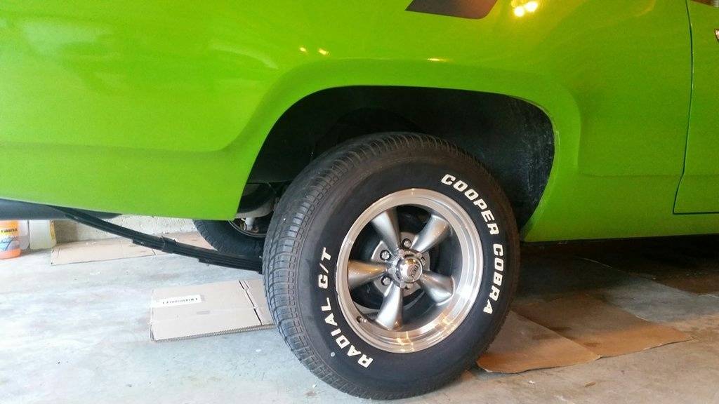

Looking for a picture of your mopars rear tires if you running a 30' or 31' diameter rear tires. Just got my +2 inch springs installed and it's skyjacking. Need to fill this big cavity with some meaty rubber. All 30-31's I see are a drag/street radial- M/T or Hoosier, I like the look but can't seem to find a decent picture out there of how this may look on my car. This wheel /tire search is really taking some time to find the right combo. Would like top stay with a 15' wheel. Must have looked at a thousand styles. All the one's that peak my interest do not come in a 15x9 or 15x10 with 5.5 BS. So I jumped up to look at 17' wheels and here I find the correct size and BS, but cannot find a 30'-31' tire in a 17' wheel. So as I've read in other threads, it's best to figure this all out before you pull the trigger on the wheels or tires.
I am not going for the "tire tucked into the wheel well look" -do like that look but not in this setup. Don't event think I could do that with what I've jacked it up to. Looking for the tire to sit just below the wheel well top lip- maybe 1' inch below. With my little 225/70/15's , I took a measurement from the center of the wheel to the lip and I have about 17', before a tire would rub. So the 30'-31' should fit perfect. 29' is just a hair to low under the lip. Would like the outside of the tire to go no further out of the wheel well than maybe 1' max. With the 5.5 BS- I'm thinking that a 12' wide tire may get me right about there. Right now I'm leaning toward the old steel wheels that I see powder coated in black, with some dog dish center caps. Was seeking a more modern wheel but cannot find the right fit. Do not want AR torq thrust wheels, although they do come in the right size. Any input/pictures is appreciated.

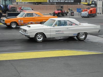

Be sure to figure out how much clearance you have to the front of the wheel well opening (forgot I had modified my '65 Coronet wheel wells with the 2# hammer). That was a problem when I ordered my 11.5W x 29.5 slicks that are really 30.5" diameter. A 30 or 31" tire may be very tight on the front of the wheel opening.

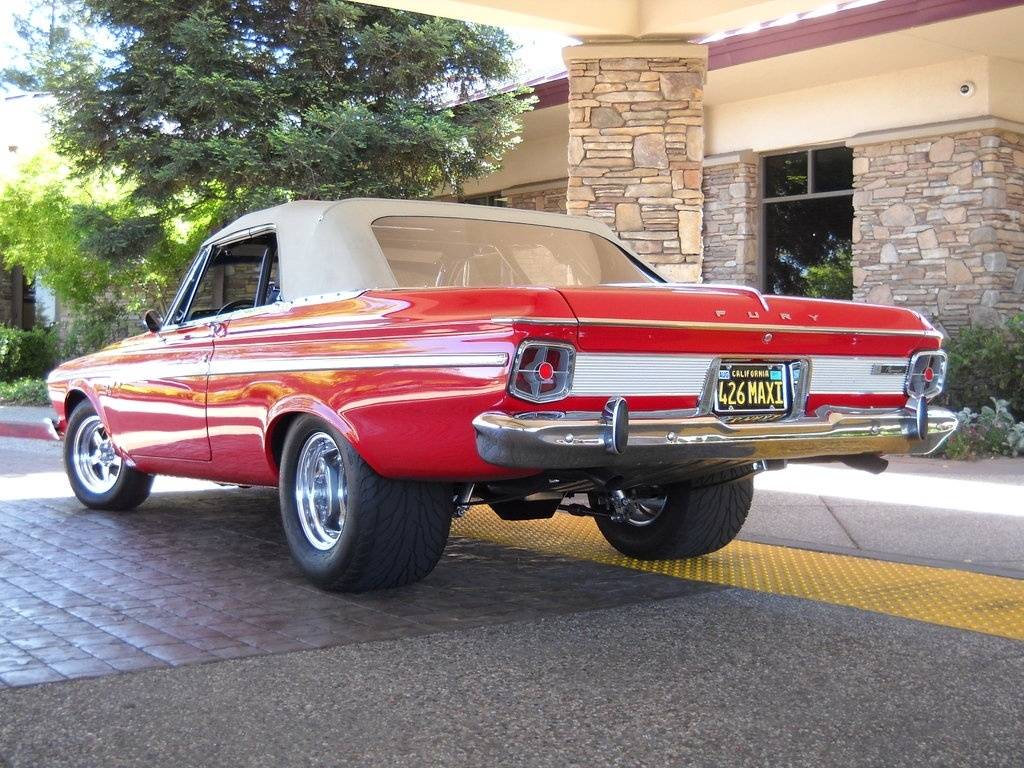

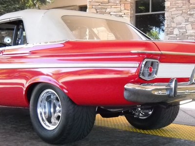

Thanks for all the replies. Those M/T 's are a good looking tire on that Fury coloradodave. I'm leaning toward the M/T's. JG1966- what's the backspace measurement on those on those Weld's? What kind of room do you have on the front and back of those Kelly's? I looked it up and that's a 26.60 inch diameter. That's a little under what I have right now. I've elected to get the biggest tire I can get in there- that will fit the front and back of the well- and then have a spring shop maybe drop it down a bit to a decent height. I can't send them back since I painted them before install. Did some research today and I'm leaning still toward the black powder coated 69 cop wheels. The size is right on.
