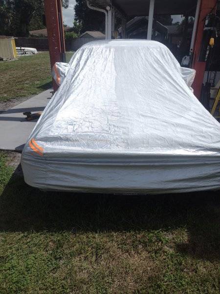

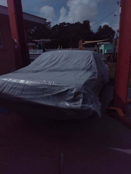

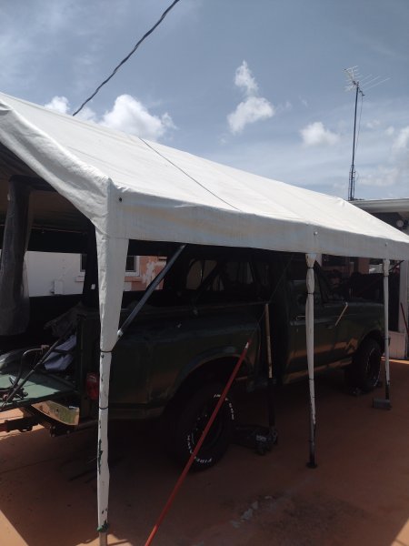

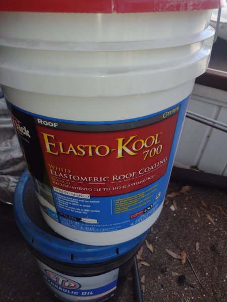

Been blowing thru a car cover and carport top a year because of sun break down. Tried the rubberized silicone white roofing paint on a carport cover two years and a hurricane ago and it still looks newish . Decided to try it on a car cover. Put the old tearing up cover on the car then taped visqueen covering everything to the ground. Put the new car cover on top and used a 4" roller to coat the new cover. Cover remained soft and flexible . Will see if I get the same results as the carport cover. Did this to a kayak cover and it's now two years old also. Added benefit to the car top was it lowered the underside of the covers temperature 35'F.

I used it on a RV awning. The awning had just about had it so I figured it couldn't hurt, still on 5 years later.
I'd be concerned with condensation trapping under the car cover in that climate.

It's a waterproof cover to start. You think it breathed?
If the cover doesn't breathe.....not good especially if the car has good paint on it. I built a steel carport behind my shop 30 years ago and then tethered it down and haven't lost it yet and it survive hurricane Ike....and I'm in south east Texas 9 miles from Galveston Bay. Most of my junk is inside my shop but a 95 Dakota lives under that carport (along with a bunch of other junk) and has been doing ok. If I needed something covered, the carport will protect the breathable cover. I have a buddy that covered a car in plastic then put on a car cover then a trap thinking it would protect it.......nope. Blistered the crap out of the paint.
