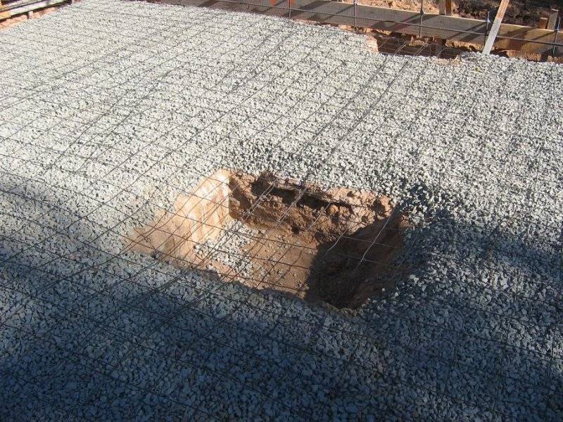

You want to see overkill?
24 x 24 16" deep at my shop!
Yeah....I played it safe on my own place!

I went in after that picture was taken and slipped in rebar at the bottom.
Yup, I gotta say that should suffice :thumbsup:
And I was bracing myself for someone to say something snide about excess in response to how much concrete I had poured. But you done did good with yours, wow.
