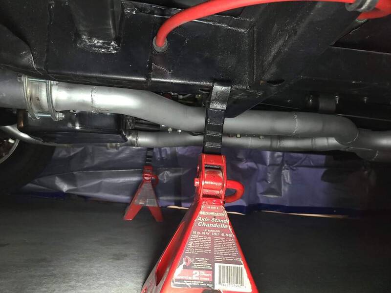

No. People do it all the time. I would put jack stands in the middle of the car too, that way the car is supported in 3 spots.
I like the front jack stands under the K member. That’s where all the weight is. If you put them under the front rails by the front door post the front engine weight is out past them and hanging,
I like the idea of Jack stands under the k member too, and since he has frame connectors he can put them under the doors and a 3rd set under the factory jacking points.

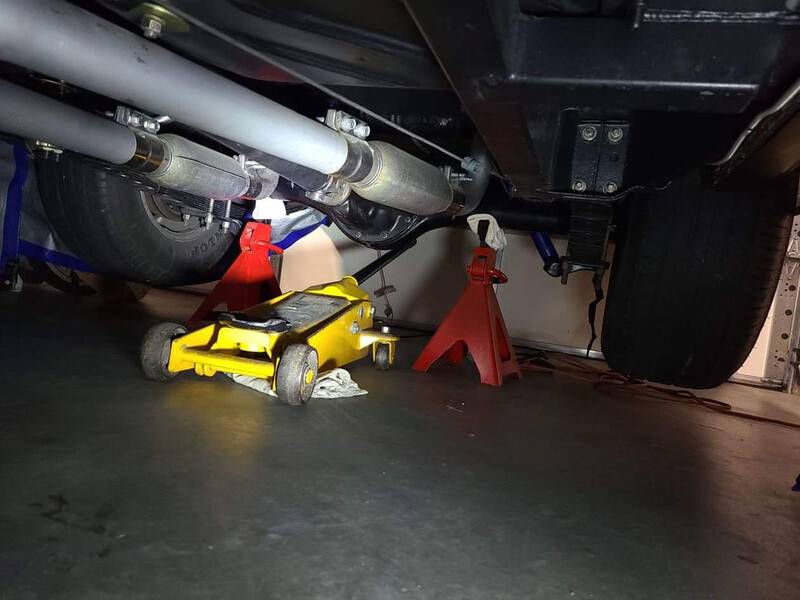

If I were to store a car on stands I think I would leave some load on the suspension. Stands under rear axle and the under control arms out towards the tire.

If you place the jack stands under the rear axle and lower control arms so that the car weight is still being carried on the suspension system, your doors will open and close as normal. Putting the unit body on stands introduces different stresses on the body, possibly temporarily affecting panel alignments. Another storage tip is to turn your sun visors down, so little critters do not have a shelf to sit on while chewing their way through your headliner.
