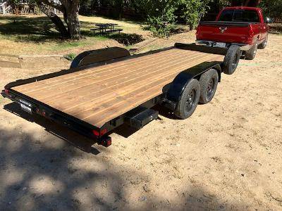

Boom. The day finally came.
Big Tex 18 footer. I wanted a dove tail but they are harder to find than I thought.

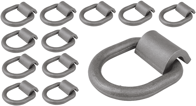

I had the wife order these......
A 12 pack of "weld on" D rings for $45 from Amazon.
Now I just need to decide where to place them.
Here is a link ......

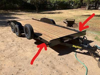

A friend suggested welding the D rings on the outside of the side angle iron in the places depicted below.
He also suggested welding one each on the rails leading to the tongue....not sure why.

When you tie down you need points further ahead of the car so you can grab a solid point & pull forward & side to side at the same time, you should be pulling both sides towards each other across the trailer... You do that front & rear... The rear tie downs are critical to prevent the load shifting forward under hard braking.... In the past CHP required that the rear tie downs were chains, not webbing.. Don't know if the rules changed but I don't see cars chained much anymore...
I would consider adding a winch, if I were doing it, the winch would be on a hitch type mount so it could be attached to the truck hitch or to a hitch mount fabricated & attached to the front of the trailer....
If you want to do the cheap version a hand crank winch like is typically used on a boat works too... Not a nice but cheap & doesn't require adding a battery box...
Last week there was a particularly ugly accident near here, a 1 ton dually flat bed towing a trailer hauling a backhoe & a bobcat discovered a brand new sink hole on the freeway... Honestly I'm surprised the guys weren't killed but apparently they had the equipment chained well & when the truck hit the hole & abruptly stopped the trailer mostly stopped too, it did rip the hitch off the truck & the trailer flipped but it didn't go through the truck, it went to the center wall & wound up on it's side along side the truck...
33 IMP
10:59 AM
Dec 21, 2017
9,466
13,827
taxifornia,soon 2b Arizona.
I wandered around Irwindale tonight, and looked at wood deck trailers. Most had loops welded onto the outside of the trailer frame, so that the loop was above the frame. Loops as far forward that didn't interfere with winch or toolbox mount, and as far rearward as possible.
Extra d-rings in as many places as possible is a plus.
I agree with your friend regarding placement.
I did see steps looped through the stake holes too. I don't think I'd do it that way.
Edit. Straps. Damn auto-correct.

I don't feel comfortable strapping down a car through the stake pockets. The edges seem like they would fray the straps.
Nxcoupe
1:59 PM
Jul 4, 2021
2,036
2,103
Red Lion, OH
I agree with wild rt, I would put 2 at the rear most corners of the trailer, but on the rear angle iron, not the sides, then do the same on the front. X rear and straight on the front and always, always attach to rear axle and lower control arms, never to the frame. The vehicle moves up and down as you tow it, and if attached to the frame, a large bump can dislodge or loosen your straps. I see guys do this at the track and I cringe. I'm one of those few folks that have had a car come off the trailer on the expressway. No one was hurt, car wasn't damaged, but it left a lasting, burned-in impression on my brain. If I ever see any of you at a car show, ask me about it.

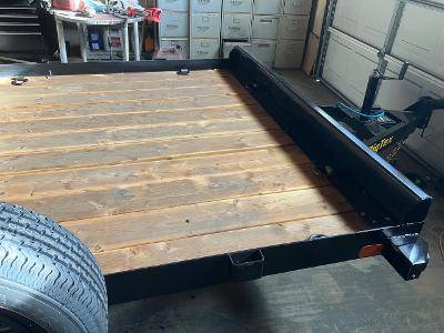

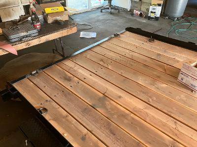

I backed the trailer into the shop. Tomorrow I hope to start welding in the D rings. I have them placed about where they will go.
I do wonder though if having them in direct line of the ramps is a good idea. Maybe move them inboard a bit?
The Jigsaw Charger tire track width is in line with the second board in on both sides. Maybe I'll weld the D rings in to center of the third board like I have it figured for the front.

In the rear, it kinda depends on how you want to secure the car. I towed two different cars regularly. On the 62 I use axle straps and then tie-down straps. My Tina, I used the wheelie bar mounts as the secure point.
I generally use axle straps on everything, but that sometimes means the vehicle carried has to be all the way to the front to account for the extra strap length of the axle straps. If you get axle straps, get short ones. If you use axle straps, put your d rings in line with where they will be.
My Opel uses axle straps on both ends, but its small enough that that is not a problem, even with my short little trailer.
Nxcoupe
1:59 PM
Jul 4, 2021
2,036
2,103
Red Lion, OH
I would spread the rear out further than the ramps. That's how all my trailers are. I also cross the rears to more secure the car in its location on the trailer.
