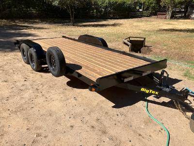

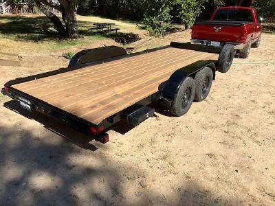

Make sure you pay attention to what manufacture says to do to protect that wood deck. I have seen so where they did not and it can get costly. Plus if for any reason you decide to change to anything else, the better it looks the more you will get for it, and if ya find it is perfect for you, maintenance easier and cheaper than repairs.Boom. The day finally came.
Big Tex 18 footer. I wanted a dove tail but they are harder to find than I thought.
$4300 plus all the extras......Like a SPARE tire, brake controller....
Tax and license. All in, $5400. This is a 7000 lb rated unit that weighs 2000 lbs on its own.

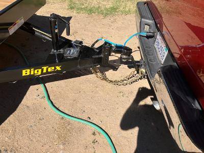

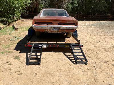

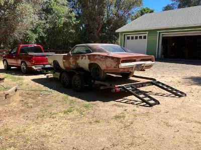

I brought out Jigsaw and did a test load.
I didn't need any tricks to load it. I thought I'd need to back the truck tires onto some ramps or make some extensions for the steel ramps but it went right up.

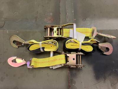

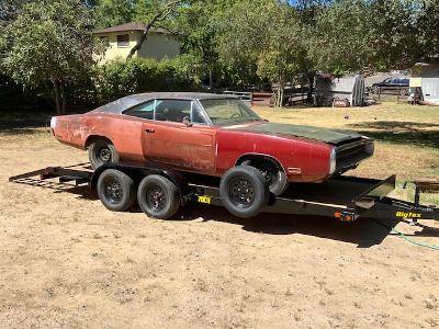

NOW I have to find a way to tie the car down. Every time that I have hauled a car before, the trailer had it's own tie downs. This trailer has no D rings, just the stake pockets.

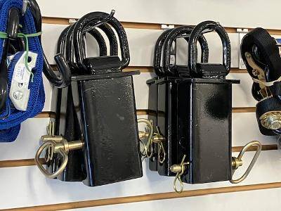

The trailer store had these on the wall:
They slip into the stake pockets and look like a decent solution for some cargo but I'm not sure I like them for tying down a car. I think I want something lower so the straps don't rub the body on the car being transported.
My dad built homes for a living, as we grew up we worked with him. I do know enough to make myself dangerous. Carpenter - not even close! But I believe that's why the wood "maintenance" is so important. On steel deck or steel ramp trailers they of course weld the d-rings. For those that have them, Would "through" bolting the D-rings and their brackets to the deck work. this is of course is using a very "hard" bolt and it's fasteners? I would guess grade 8 or 10.Thank you.

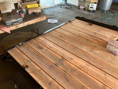

As a carpenter, I was disappointed in the deck. Structurally it is fine but the gaps between the boards are inconsistent. That really annoys a guy like me.
