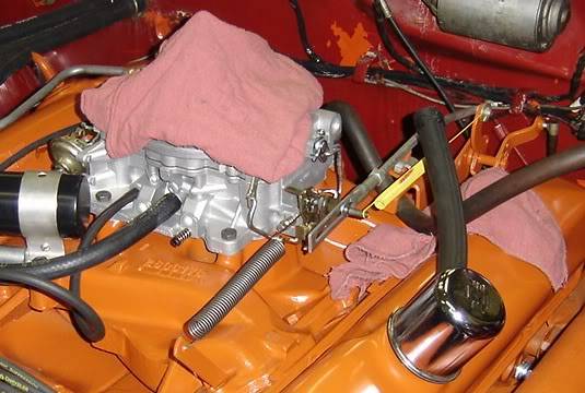

Sometimes, I even impress myself with my drawing skills...:grin:
Thing is, you made it stupid simple. Anybody that didn't know a thing about Mopars would know where to put that sprAng. lol Nice work!
The throttle cable bracket may be from a 2 BBL car because I think there is a difference between 2 BBL and 4 BBL. You can do some "re-engineering" (i.e. cut and weld) to make it line up better.
I like the spring!
