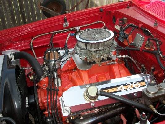

Just thought I would let you know I have been using this Lokar throttle cable setup on my 63 since 2006. And its worked flawless for me racing and driving on the street. Good luck with yours what ever you use. Ron
383 man, I would like to order the throttle cable your using on your car. Could you give me a part number from summit for that cable? Thanks for posting that information. Tom.
I don't remember the part # as I bought this one in 2006. But I can tell you I bought it from Mancini and I just asked for the Lokar cable that will work with my 63 Sport Fury. It was the kind that I cut to the lenth I needed as it came very long to fit most any car and I believe I bought the mounting bracket on the carb separate as I don't think kit came with the cable. The bracket is also a Lokar part. Hope that helps some. Ron

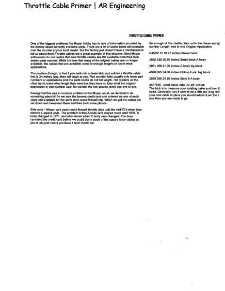

We use the stock 6 cylinder cables. Plenty long enough even with tall manifolds.
