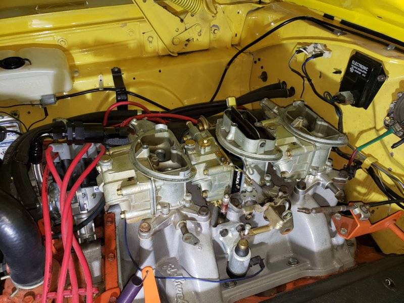

I know. I couldn't pass up an opportunity to showcase the 3x2 setups in the pictures, the 3x2 Holley topped Edelbrock/Chrysler aluminum intake on my 70 V-code Roadrunner being one. :D

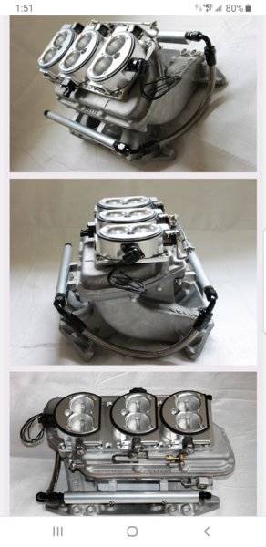

Efi is by far the best, the throttle bodies are gigantic, and they all open at once.
