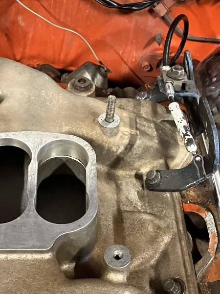

Are you talking about a metal spacer or a black gasket spacer? Thanks
https://www.amazon.com/Holley-108-12-Carburetor-Base-Gasket/dp/B00029J4KG/ref=sr_1_1?sr=8-1 (https://www.amazon.com/Holley-108-12-Carburetor-Base-Gasket/dp/B00029J4KG/ref=sr_1_1?sr=8-1)Are you talking about a metal spacer or a black gasket spacer? Thanks
Item #1. Heat isolation....depending on what it is made from....the R value or resistance to heat transfer.There are probably at least a few benefits to a spacer, but mainly academic?
1) isolating the carb from heat.
2) it gives the intake charge a more gradual turn into the runner which helps flow.
3) it increases plenum volume.
I used one a long time ago mainly to address concerns regarding heat.
That’s a base gasket not a spacer. And yes, you need that. The choke won’t be set right with out it.
Yeah Wayne, I can’t believe you didn’t know that. ShhhheeeItem #1. Heat isolation....depending on what it is made from....the R value or resistance to heat transfer.

Choke is electric. It’s the massive leaking that bothered me.That’s a base gasket not a spacer. And yes, you need that. The choke won’t be set right with out it.
Well I torqued everything correctly and it just blew loads of fuel out the base
Holley says 108-12 “Base Gasket 1.75 in. Bore Size .3125 in. Thickness Fits Holley 4160/4150 and four barrel TBI flange pattern”What is the thickness of the carb base gasket you removed? The one you linked above is a 1/2" thick.
Also, did the air cleaner fit in the Ram Charger ductwork correctly?
Did you measure the one you removed?Holley says 108-12 “Base Gasket 1.75 in. Bore Size .3125 in. Thickness Fits Holley 4160/4150 and four barrel TBI flange pattern”
Yes I completely rebuilt the carb with all new Holley parts and set the floats.
Yes this is exactly it.Did you measure the one you removed?
