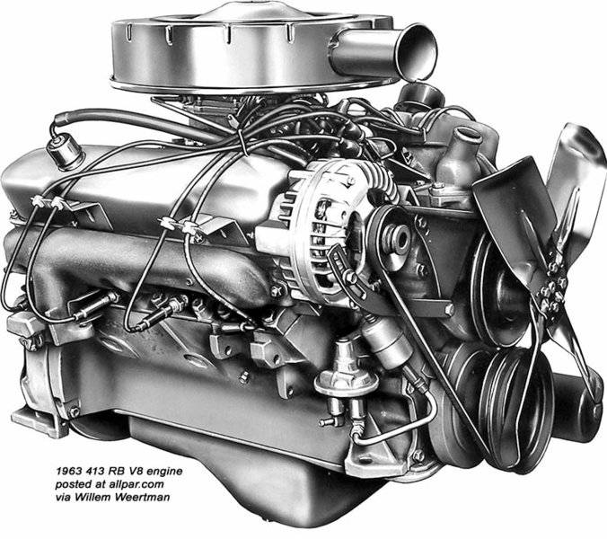

Assuming it isn't a max wedge, it should go like most RB engines, like this:
All due credit to www.allpar.com...

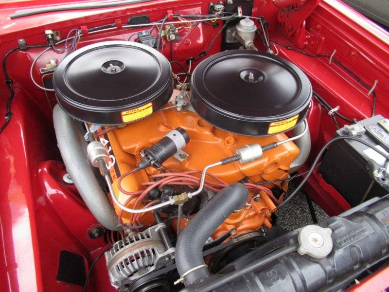

I might have a picture,special "K"s 62 Max Wedge

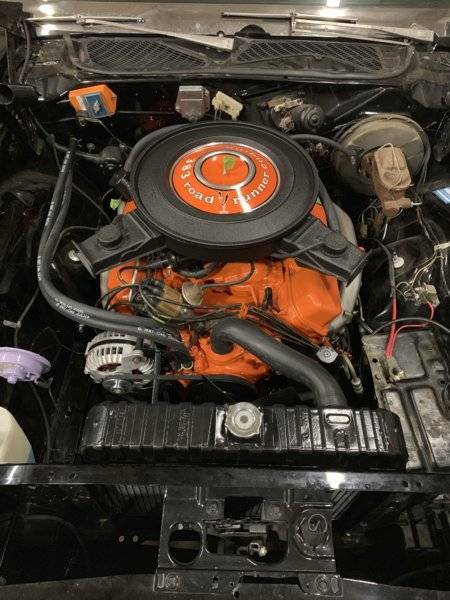

X2 in removing the alternator. Just went through this on my 71 RR. Fumbled with it for over an hour. Took the alt off and it fell into place.
