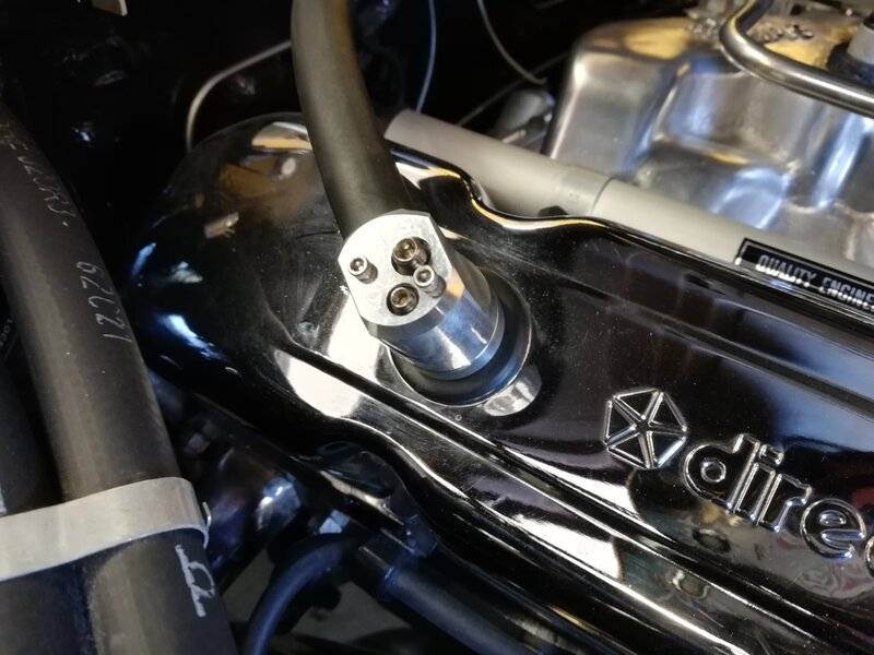

Todays update. Not much time to tinker in the garage today but started plugging vacuum sources and played around with the adjustable pcv.
Now things started to happen with the bog, opening up the pcv made the bog more pronounced, closing the pcv gave me a throttle response out of this world (Bog still remained but was located at a bigger throttle opening. When doing just a blip the bog was gone)

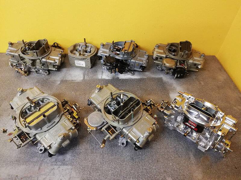

Threads are more fun with pics so Ill throw in a pic of some of the carbs I tested out last summer.
The best carb is bottom right in the pic.
500 rpm idle & smooth means a stock or very mild cam. It will also require a high number power valve, perhaps a 10.5, if using a Holley or clone.
No denying that the Avs2 is a good carb, though having test/tuned them all in the pic I can say that they all behave differently in different areas. The Avs2 won in some areas while the Holleys won in others.
My self built carb takes all winning areas putting it into one carb and it has already showed that it can deliver.
For PV the Classic Holley really liked a 9.5 on my engine.
Is your Wagner PCV set for dual flow mode or fixed orifice?
Try fixed orifice mode to ensure it provides a steady air flow to eliminate the possibility.

As i read from above it does make a difference after you played around with it, it could be your "vacuum leak" at light throttle.
http://mewagner.com/?page_id=459
I tried both Dual and fixed. It does make a slight difference playing around with different settings, though bog is still there stalling the engine.
