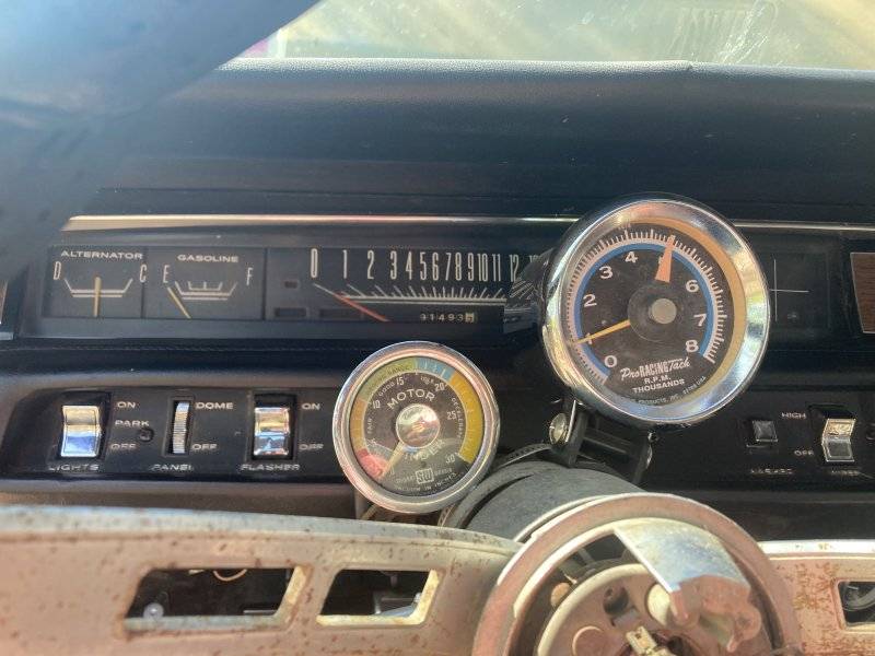

Yes Ceedawg, I have a Stewart Warner motor minder, that I bought kinda because it was cool, but quickly discovered just how important it is as a tuning tool too. It’s been driving in the 15-16in range with all of my changes.
