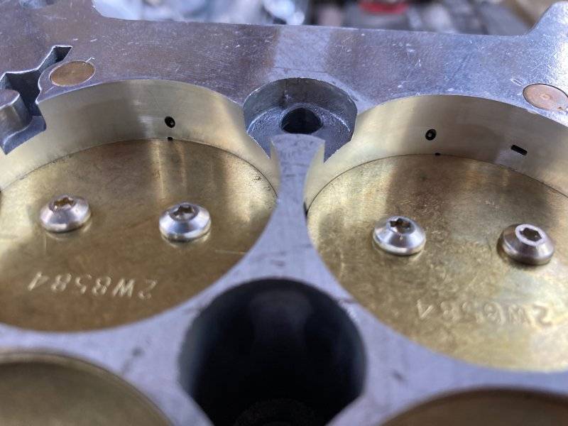

- remove carb to check T slot position; correct if needed as I described earlier.
The T slot position is absolutely critical. If too much is exposed at idle [ most common problem ], not enough slot is left for the transition [ that is what the T stands for: transfer or transition ] to the main system. Result is flat spot &/or lean spot. You do not fix that, & you will not fix that, with jets & rods.

My transfer slots are at .022, so that’s in spec too.
