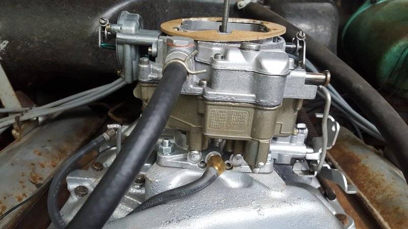

Anyone have experience with a WCFB?
Purchased a completely refurbished and rebuilt 4 barrel WCFB and intake, bolted it on, started up, does not idle.
I adjusted everything, per a 57 Dodge manual, including floats, float drop, accelerator pump, etc.

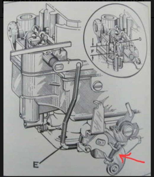

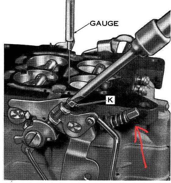

Also, adjusted the metering rods, although the manual is not very clear on this, at least to me, page below.

Does it have the idle screw? Sounds like it's running okay just need to open the throttle plate a bit.
The above picture is the choke fast idle. These pictures are showing the throttle stop.

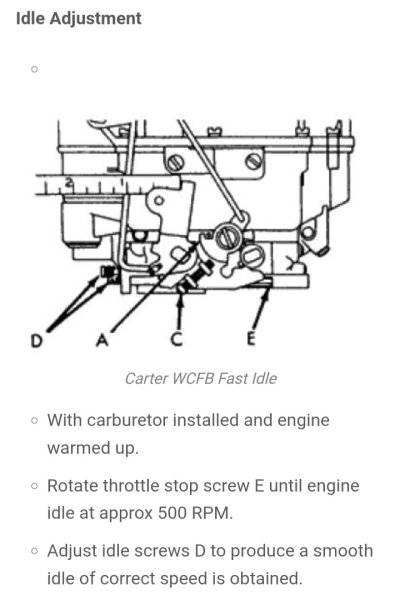

I copied this from this site. Highlighted in red are links to troubleshooting and parts. It does look like the mixture screws are missing? I can't find a picture looking at it head on to verify.

The above picture is the choke fast idle. This picture is showing the throttle stop.

I totally agree.....someone did not install the idle mixture screws. IMO...without the mixture screws, air will be sucked in and because there is a definite lack of vscuum in the carb's idle mixture passages, fuel will not transfer from the jets, air bleeds to the idle mixture transfer and off idle circuits, resulting is stalling due to a very lean condition. THE IDLE MIXTURE SCREWS MUST BE PRESENT FOR PROPER OPERATION. Just my opinion of course. See attached pix below. Its not your carb but is typical of the WCFB design.
BOB RENTON
Yeah, somebody took the screws out and lost them. Maybe AFB screws will work?

It has the idle speed screw, difficult to get to with a screwdriver but easy with a small socket, as well as the fast idle adjusting screw.
I adjusted both, but the only fuel it's getting is from the accelerator pump.
