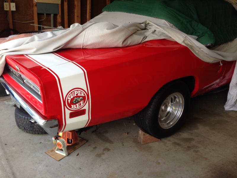

So, Friday 27 Feb I took a day off here at work and ran to Fresno, CA to pick up a 489 3rd member (3:55) I had just bought.
The guy is a great guy! He held it for me for a couple of weeks.
I made the 175 mile journey and this is what I found in his garage:
Also, be advised, it may be for sale...I get first pick he said.
BUT: He blew the engine because he "Revved" it up to 6,000 RPM 2X when his brother was here visiting.
(This guy is much older, and he is getting tired of working on the car etc)
My point:
RPM kill "Non-race" built engines....
