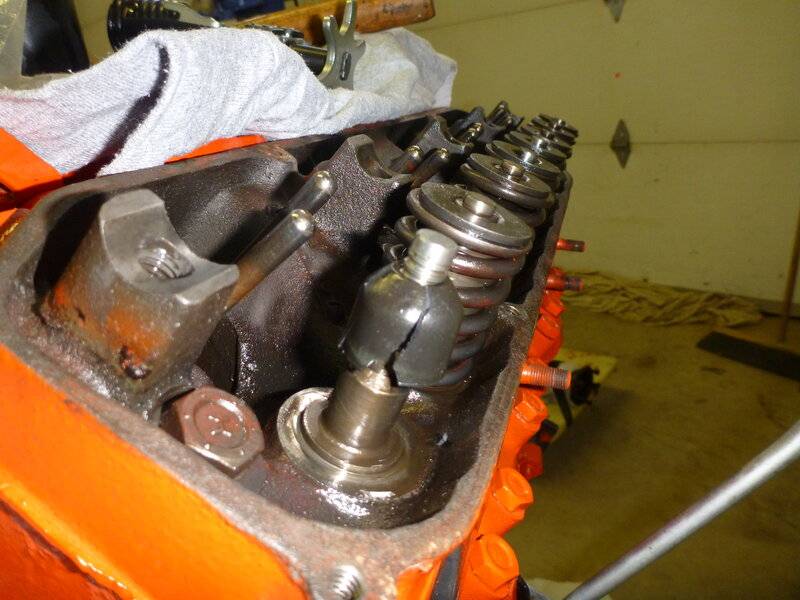

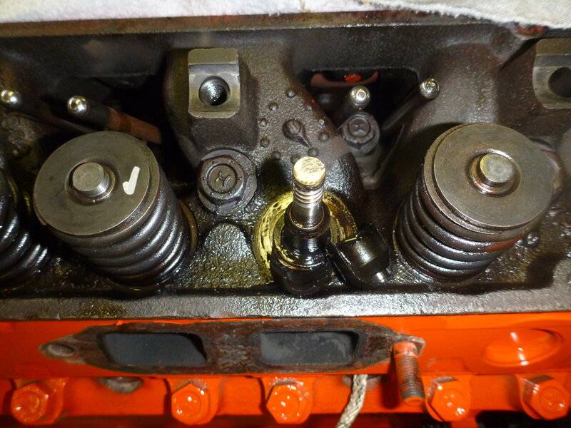

Possibility valve guide seals. How old is the build? How many miles on the engine? How is the oil pressure? It could be a lot of things. Rings, valve guide seals, are a couple of things that come to mind.
Yes, most likely bad valve seals. How old is the engine? If it is an original engine with cast iron heads then the oil seals are most likely as hard as a rock. That is, if they even exist at all. After 50 years they have probably disintegrated into dust and are in the oil pan.
Not sure when it was rebuilt if it was at all lol runs pretty damn good though.
Oil pressure is holding at 40.
Where my money is betting! Easy place to start and change without pulling the heads.

Great, thanks for the pics as well!! I’ll do this.

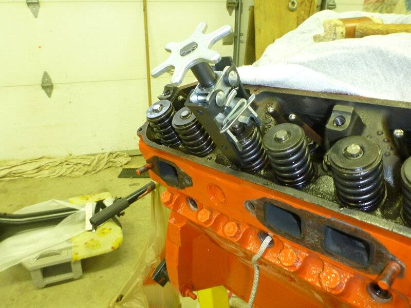

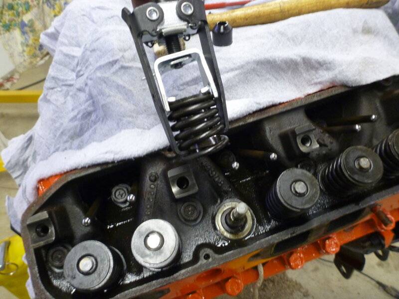

Is that a tool to remove the springs? When I put the springs back, do these still have to be measured for height, or just put them back to their respective spots?
Pull the covers and just get a good flashlight and look in through the valve springs to see if your seals are cracked or broken in half just lying in there. If the seals are toast... you can stuff a rope in each cylinder and bring the piston up towards TDC and it will hold the valves in (cushioned by the rope). Valve compressor tool (about 20 bucks) will compress the spring so you can remove the valve spring keepers and then the springs. Change both valve seals and reinstall the springs, compress again and put the stem keepers back in place. Repeat for each cylinder. Simple as that if it has stock rockers...
While you have each spring off, give the valve stem a good tug in all directions as a "wobble test". If you can feel them move you may have more problems.

Why I use a rope and I don't see how you could leave any in the cylinder. Stuff some rope in, piston up and it holds the valves in place cushioned by the rope for zero damage. Air.. piston at bottom and you lose the air supply, then the valves go clink...

To OP, valve guide seals are the likely cause. The tool shown in posts #6 & 11 works well with stock springs. The rope method really works, you need to hold the valve closed when removing the spring. I used about 6' of cotton cloths line, pull the spark plug, feed the rope in & turn the motor over by hand till the piston stops, compress the spring, remove the locks, install new seals, reverse process to re-install. I had cloths line, a lever style spring tool, spare rocker shaft, spare valve springs whenever I went to the strip. Changed many broken valve springs in the pits or staging lanes using this method. Won numerous races because I could change springs quickly.
I just did mine too. I used a long bungie cord with one end cut off and a home made spring compressor. took about 2 hours.
