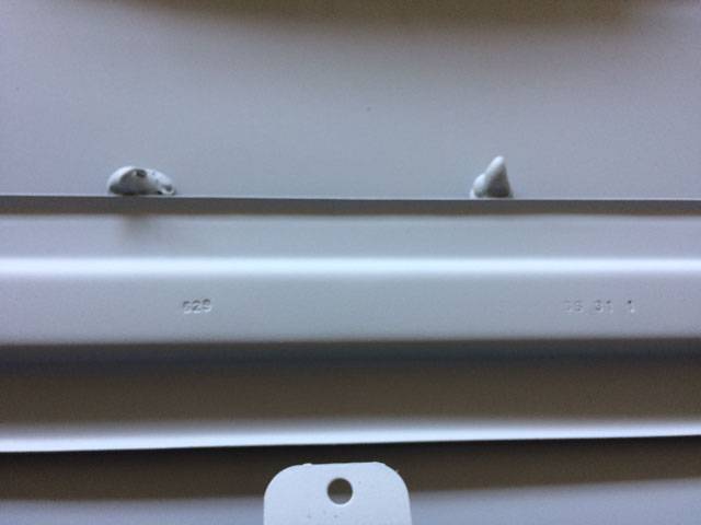

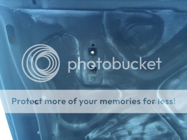

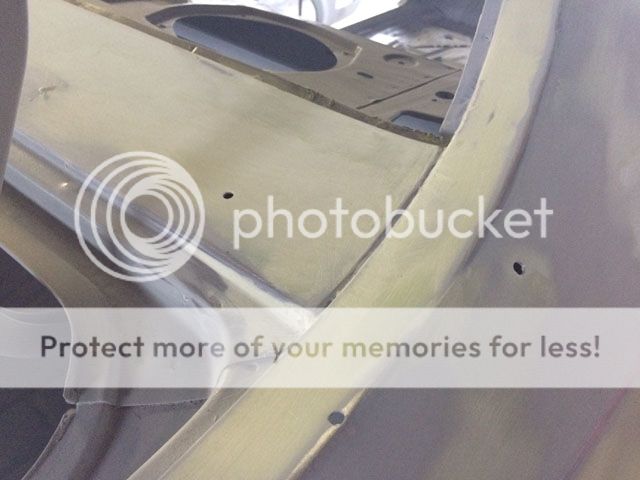

Smoothing out all those bumps created by stuff banging around in the trunk (well further toward the rear):
From my latest visit, some random pictures.

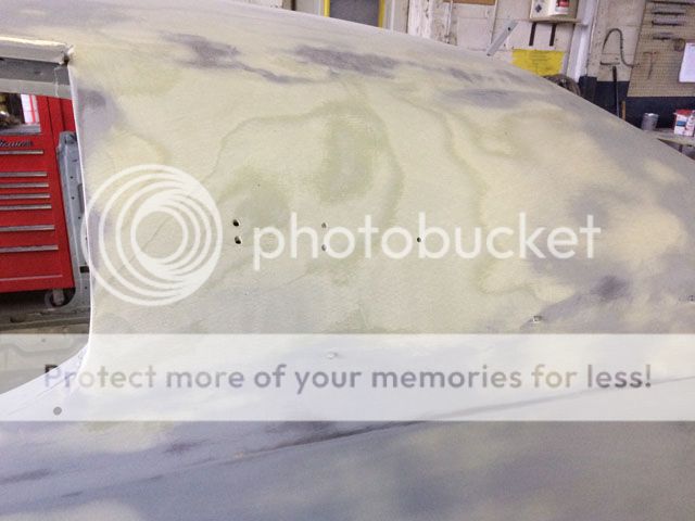

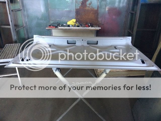

Back in the shop now, ready for putty and high build primer.

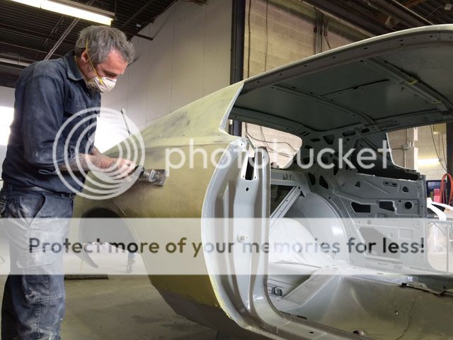

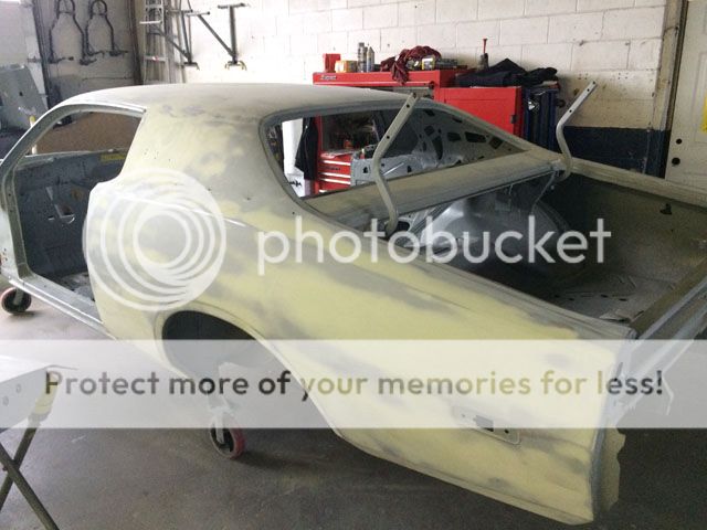

Went by this past weekend, the guys are blocking the high build primer to 220 to find and remove any high and low spots. Pics sent to me by the shop:

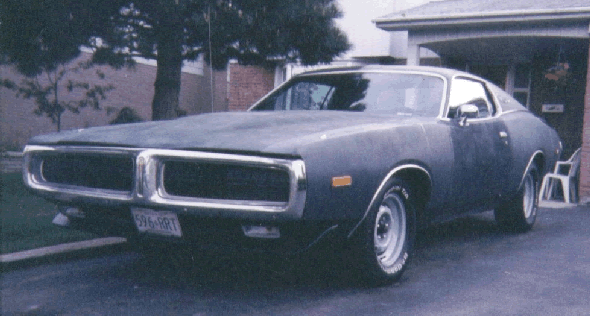

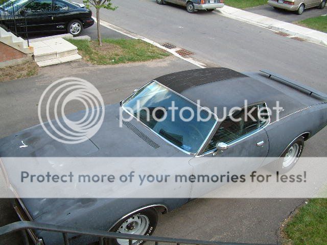

This is my Y8 1972 Dodge Charger SE Brougham (production date 7-71) that I purchased from Nigel at National Moparts it was a rust-free North Carolina car that was parked due to a bad transmission and brought to Canada. To keep it running and because it was also a 318 car I swapped in my old 318 & TorqueFlite 727 from my first SE and drove it for about 5 years. It was last registered and on the road in 1992. It's traveled with me from place to place waiting for a restoration. I am not a mechanic (or a body guy) but I have enjoyed working on my cars since I was young. I learned a lot early on from not having a lot of money to pay someone else to do the work for me.

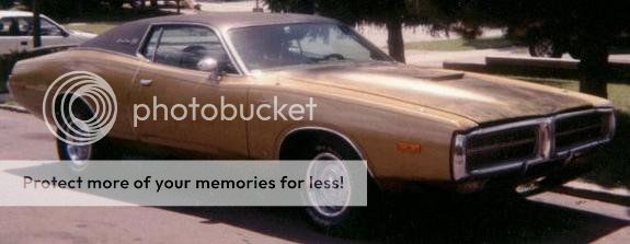

This is basically how I bought it in August of 1992, I put on my Western Turbine rims that I had on my previous SE. It did come with 14" Rallye's which I sold to a guy with a Challenger. Then I bought a set of 15x7 Rallyes from Motor City Originals. Shortly after getting it home I added the Year One front spoiler, I also added the dual cut-out exhaust rear valence from a '74, it was pretty rusted, I cleaned it up and painted it, thought it looked cool even though my exhaust was nowhere near the openings. I never would have thought that many years later there would be new ones being produced, thanks AMD.
Those are P275/60R15's on the rear and up front P255/60R15's.

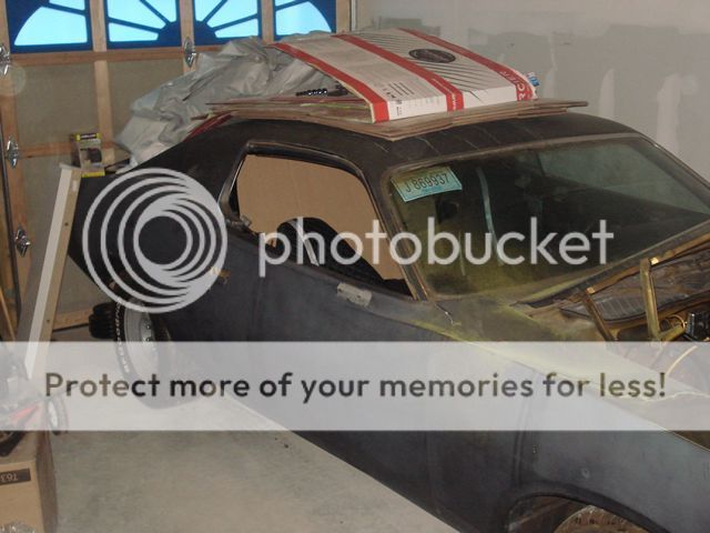

Here she sits, March 2007 just after me moved to the new house, double-car garage... finally, now I'll have some room to work on it. Don't really have a budget, I'll probably fund some of it by selling some of my extra "back-up" pieces (yes still have a few). This will be a slow restoration that's for sure, I'll be doing as much as I can.

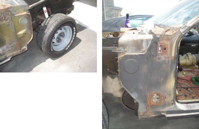

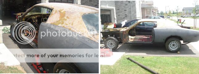

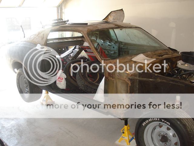

Removed the hood, decklid, fenders, doors, etc.
Not too bad behind the fenders:

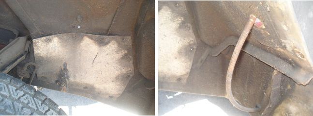

Quite a bit of undercoating.

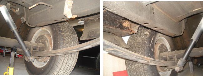

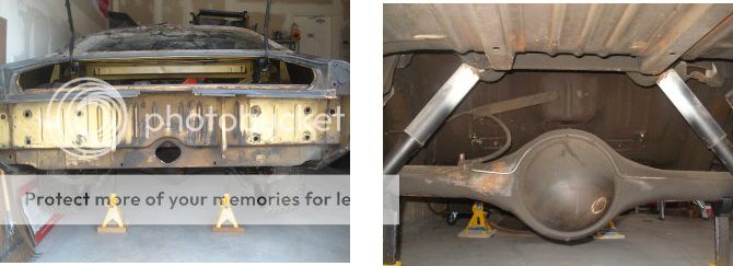

Some rear shots:
The car is pretty much fully covered with factory undercoating:

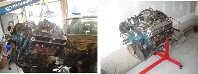

Couple of my 318 from my previous 72 that I installed in this car:

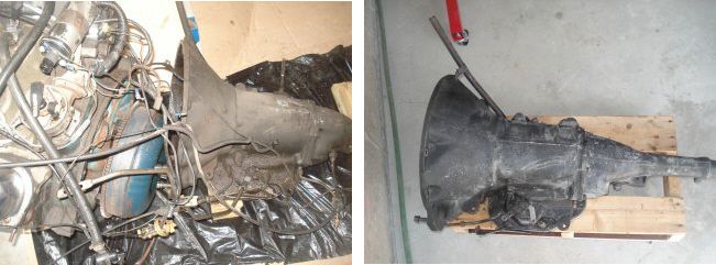

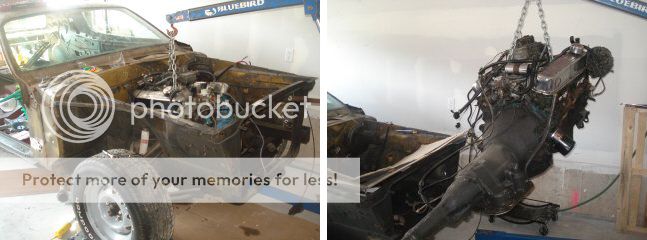

Rented an engine hoist from my local Stephenson's Rental, took me about two hours by myself (I did take my time) to get it out, as you can see I left the tranny attached and pulled it out as a unit. I had to let the air out of the two front tires to give me enough clearance over the radiator frame. Maybe I could have gone higher with the jack but was a bit fearful that my anchoring bolts on the engine may give way.
Transmission separated:
After 18 years the 318 is out again.
Rolled it outside, you definitely don't see anything like this in my neighbourhood.

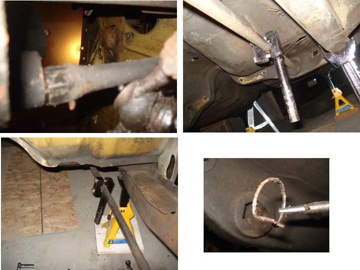

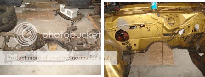

Removed the torsion bars, wasn't as bad as I thought it would be, really had to whack them though.
Then I removed the 4 bolts for the K-Frame and dropped the whole assembly on to some blocks temporarily.
Here's the front suspension:
