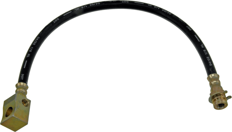

The rear brake line with the block molded on is later models
NOT 1969

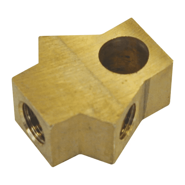

Okay after replying from an ignorant state of mind I decided to go look at my 69' C-body 8 3/4 and I see exactly what you mean and exactly what your talking about. Now all I gotta do is find the distribution block that bolts to the diffy housing.

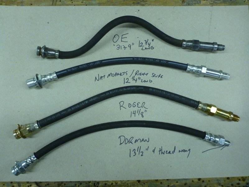

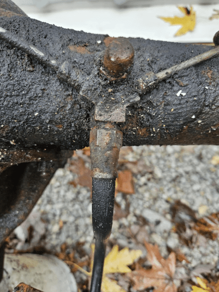

Older rear axles had a Tee fitting so the rubber flexible section screws into it.
It's held in by a special vent plug that threads into the axle housing.
Like this:
