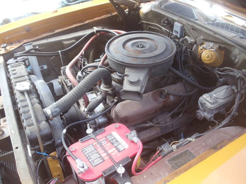

This is a '72 Plymouth Satellite Sebring Plus 318/auto. I have used 3 voltage regulators, the one that came on the car when I purchased it and two aftermarket units. The same thing with any regulator: no charge at idle speed but charges like a champ at any speed above idle.
This change is verified by voltmeter and by watching the dome light, which gets brighter above idle.
I am not going to worry about for now, because it starts and runs down the highway just fine, including some over 3,000 mile road trips.
However, I was wondering if anyone else has experienced this with their own Mopar charging system? P.S. Once in a while, I believe I have found it to charge at idle momentarily.
I thought that was normal? I notice it at night, the lights get noticeably brighter as soon as the revs rise, even slightly. Mine idles at about 700 rpm, and the ammeter shows not much charge or nothing, but once I get to even 800 rpm the gauge moves to a charge position.
Your picture shows what appears to be a high quality battery. If your battery is fully charged, the regulator may actually be cutting off charge at idle unless a lot of accessories are on. Try turning on your headlights to load the system and see if it starts to charge at idle. I have noticed on many of my cars that the amp gauge just waves back n forth at idle with the battery fully charged.

yes but no... there are limits on this. with stock alts you barelly increase the rpms by 100 or 150 and will increase the load able to keep the charge. The OP description sound as a more radical situation.
BTW, trust me, upgrade the alt and your charging system ( alt ) will be safer. The ideal reading is 0 on ammeter
stock alts are able to feed maybe 18 to 25 amps while iddling, and our cars maybe sucks out 30 amps, so you have a 5 to 12 amps deficiency. That load is being sucked by the car from the bat. When you give RPMs, the alt is able to source the car needs and get back what the bat lost previouslly. Thats why you have the back and forth amm needle.
If your car need to get 30 amps iddling, the best is get an alt able to feed AT LEAST that while iddling. That will cover everything and the amm will be steady at center, and batt will be never sucked out, which also means, the alt will never need to recharge the batt back

Do yourself a favor regarding my explanation of how a Mopar alternator works. I'll repeat a brief explanation of the system.
The Mopar alternator uses a 3 phase full wave bridge rectifier circuit which changes the voltage and current generated by the stator windings to DC voltage and current. The rotating field circuit, whose voltage is regulated by the fire wall mounted regulator. The maximum AC current produced by the stator is limited by design (impedance - which is the AC equlivant to resistance) and changed yo DC by the 3 phase full wave bridge rectifier circuit.
If any diode in the bridge rectifier circuit is open, the alternator will only produce HALF of its rated output. This is noticeable at light loads and above idle RPM. At low RPM and high loads, the alternator's output is significantly reduced. If any diode is shorted internally, the battery will be drained usually overnite. The power drain will be thru the shorted diode and stator windings to ground....which is a high resistance ground. This is in addition to the usual advice of badly grounded regulator case or auxiliary grounds or loose or corroded battery terminals. The round back alternators use pressed in diodes that are individually mounted; the square back alternator's diodes are group mounted....all positive diodes on a heat sink and all negative diodes on their own seperste heat sink.

Like I mentioned in my post, the alternator will produce the correct voltage output (under light load) but have low AMP output with an open diode. Only when subjected to a high load, lights on high beam, blower motor on high, foot on brake, transmission in gear will the voltage and current be low (less than 12 - 13 volts). Perhaps you should have the alternator LOAD TESTED. That will show you if you have a real problem. A bad (open) diode can only be detetmined be individual testing of each diode.

I took mine to a local alternator shop and it tested fine, put a smaller pully on it and it produced 14 volts at 750 rpm.

Agree with above. A bad diode will cause your problem.
