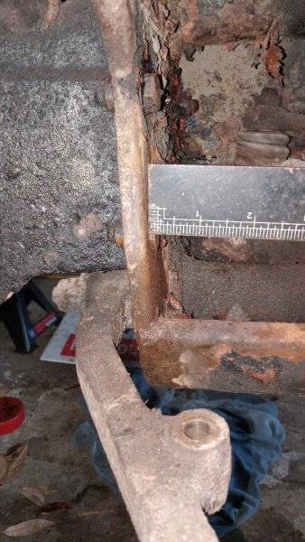

Not a B Body but I am trying to get a subframe off the main frame rails of my car. The subframe is butted onto plates at the front of the main frame rails and bolted in place.
Several bolts holding the crossmember to the frame have very shallow heads. See the lower bolt in the photo. I cannot get a socket or wrench to stay on the bolt when turning using a long bar or handle that is needed to apply enough force. Any suggestions, please????
I'd start by cleaning it all up.
Then try an impact gun, so you can concentrate on holding it with vertical pressure with no horizontal (levering) required.
Assuming you have already done the WD-40 /heat with a torch routine and it still won't budge, you could try a clamp to hold the socket down.
You could also try cutting a groove in the top with an angle grinder and use a screw driver on it. I've had luck getting stripped bolts out that way. That's a last resort obviously. (Or maybe 2nd to last)
Cutoff wheel on a grinder if it will fit. Not like you would want to reuse the old hardware if its all rusted up.

My impact gun is electric and great but won't fit in space the bolt sits in. maybe a right angle air powered one will fit.

I won't be able to get the grinder in the available space to get every bolt - there are 10 each side of the car. Some are really boxed in. I can't see how they managed to bolt it together!!!!!

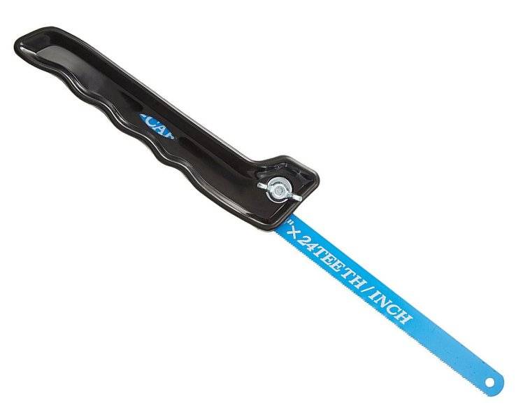

If you've got enough room to get a ruler in and take a photo then you should have enough room to use a mini hacksaw and cut the head off the bolt or nut. It might be slow work but should get the result.
using one already
