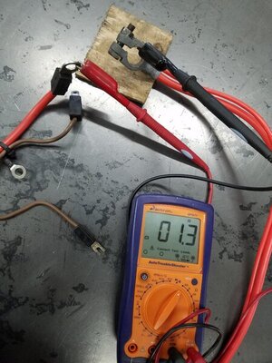

Thought I would share this info for anybody interested in such things. I had a no start issue last fall on my 69 Bee. After wiggling the positive cable on both ends, it started normal. This was one of those $40 cables sold most everywhere. Really not sure why I bought it in the first place, but ordered one of the better $130 versions to take its place. Interesting that the cheap cable showed 1.3 ohms and the better one measure .3 ohms. Not a lot, but would change the voltage drop when in use.

When you begin with only 12. x volts, any resistance can and will be a problem..

Cable diameter is not what it use to be. Go to a truck shop next time. No amount of connector will do the job with undersized wire.

The Re-pop wires look to be similar on the "outside" and I've had to cut the ends off them and found that they use more insulation than the copper wire itself...some as much as half.

The more insulation than wire is a huge issue, especially with wire from china. Buy 12ga wire and the outer diameter is 12ga with 14-16ga actual strands.
