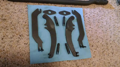

I tore down the buddy seat because the operation of the armrest never seemed right to me. Once I got it disassembled, I noticed that one of the pivot shoulder bolts backed out and was actually pivoting on the threads rather than the shoulder. So this was wearing the bolt out and wearing the pivot areas on the arms. I ended up welding the pivot areas to build up the areas and I will reshape the areas. Since I had the buddy seat in the garage I figured I had better check it in the car to make sure my mounting brackets were welded to the floor correctly:

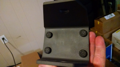

The car is going to have somewhat of a Day 2 feel to it, so some of the engine components aren't going to be stock, however, I don't want to deviate too far from the stock look. I'm going to continue running the Edelbrock CH4B intake manifold and I'm going with a Classic Holley 850 in the gold finish. The problem with the Edelbrock intake is that it moves the ignition coil mounting location. I know that there are brackets out there that move them but I had another wrench thrown into the mix. Im going to be running the factory style unsilenced air cleaner, but Im going to also be running a taller K&N air filter since Im going to be running Stealth heads, larger cam, etc. and want as much air flow as possible. So with the added height of the Edelbrock intake and 3/4" taller air filter than stock, Im running a drop base so the factory air cleaner will clear the hood and hood mat. I did a quick mock up of everything and ended up making my own coil bracket. It doesn't put the coil in the factory location, but with a stock looking coil and stock coil bracket, it will look more correct.
I made a mock up bracket out of poster board, and once I was happy with my dimensions I transferred it to .100" mild steel. I counter sunk the bracket and the bungs in the intake so I could use flat allen screws to hold the bracket down and the coil could sit over top of the bracket screws:

Blasted and zinc phosphated the shock plates and front strut rods as well:
