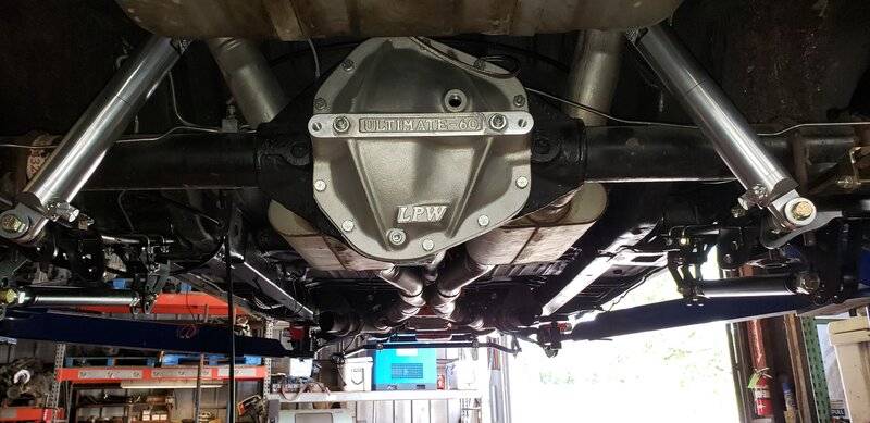

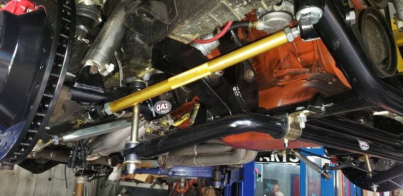

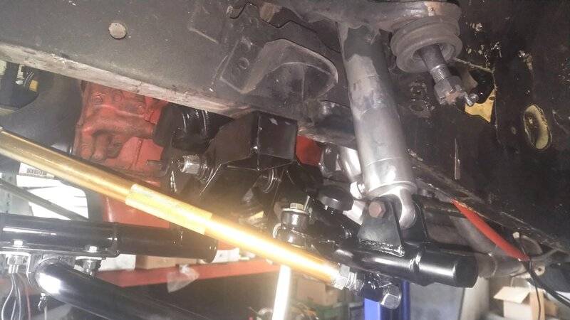

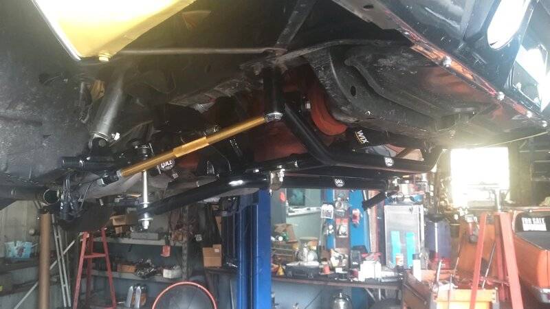

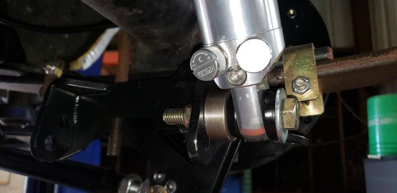

I ordered the original strut rods from Summit and they sent me the QA1 struts. Will say had a hard time to tighten the back nut up on the K member. Was not happy with the set up but they are on.
.... QA1 struts. Will say had a hard time to tighten the back nut up on the K member. Was not happy with the set up but they are on.

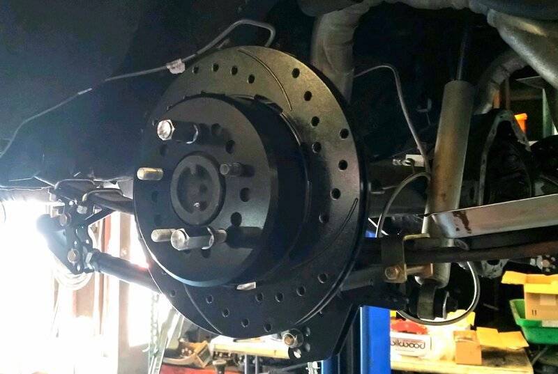

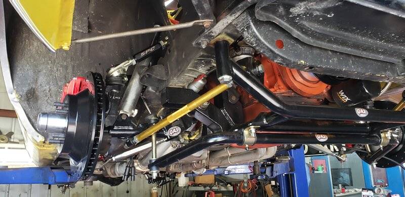

The mechanic didn't say anything about the.QA1 gold anodized aluminum strut rods he just installed on my QA1 K-member and front suspension. He DEFINITELY would have mentioned it if it would have been a problem.
Here's a couple of pics that include the strut rods, FWIW. They "look" ok to me...

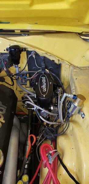

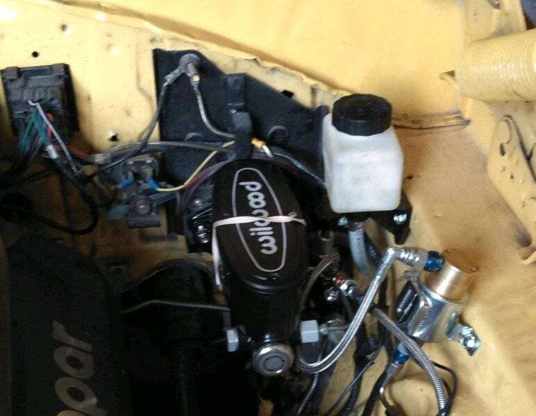

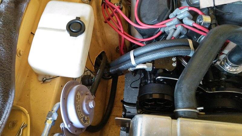

Ok, so now that the ugly white plastic reservoir has been replaced with this black aluminum one, the mechanic has moved its location as well.
The cap just clears the "lip" of the cowl firewall sheet metal, and I like the new location.

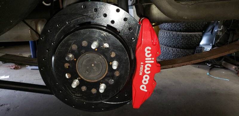

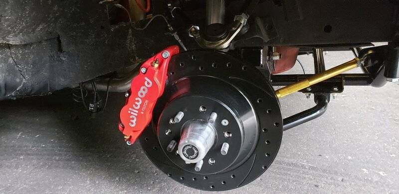

I dropped off the green bearings, so later this week all 4 Wilwood disc brakes should be installed!

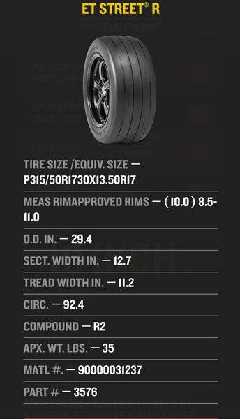

Thanks for the consideration. My Toyo Proxes TQ drag radials are 3 years old, and although they have a decent amount of tread left, I'm kinda at a crossroads.
For driving on the street and highway, I have ZERO complaints, and that especially includes the possibility of being caught in the rain.
The other job I'd like the next pair of rear tires to do is to have reliably decent traction performance in the 1320, and ALL of the qualities that these Toyo Proxes TQ drag radials have exhibited.
So I'll admit that the 315/35/17 sidewall profile of the tires I've had is less than ideal for launching my behemoth off the line, BUT I also have been lacking ANY help to offer the tires, being as I had worn out leaf springs, "meh" shocks, never adjusted the double adjustable Viking front shocks I do have, nor did I ever disconnect the front sway bar.
So my point doesn't get lost in my rambling, NOW that I have a brigade of support in the traction mission, I intend on using a good bit or all of the remainder of life in my Toyos to determine if I want my next pair of "street tires" to be Toyos, and if they do a great job at the track (that's what I expect honestly) I'm going to see if the next size up fits. They are 345/40/17. If I find that even with all the new traction enhancing goodies I have, the TQ drag radials are not up to the track specific task, well at that point I may still use them on the street, and get a better track focused DOT drag radial like these:

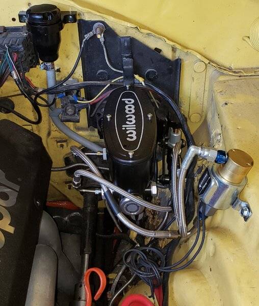

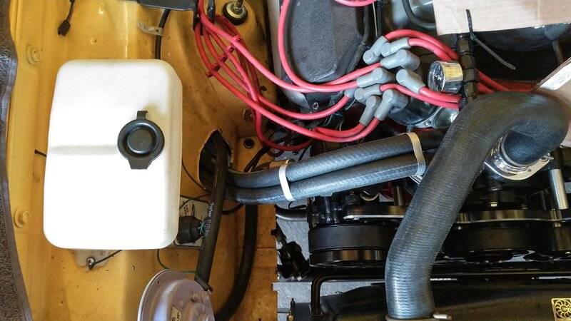

Here's a really good before and after comparison.
Once I saw that beautiful Wilwood master cylinder installed, I knew that cheap looking white plastic hydraulic throwout bearing reservoir had to go (I know I posted this already, but I'm going somewhere with this)
I decided that the black billet aluminum hydraulic throwout bearing reservoir would be the solution, BUT (and here's my point) the shop owner ALSO decided to reposition it, and MAN! I think this makes that whole fairly "busy" area much cleaner looking:
Before:
After:

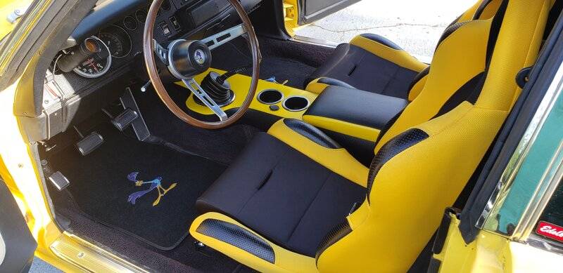

You may want to try a smaller diameter steering wheel after you get back on the road. Especially, with all the front suspension/steering upgrades. Maybe something in a yellow and black?
I like the factory simulated wood wheel with the Roadrunner horn button. I wouldn't say "No, I'll never do that" but it's not on the list right now.
If I was going the "road course" route, definitely.
I'd say the most likely candidate if I did make a change is the factory "Tuff Wheel" steering wheel. I had one on my 79 Aspen R/T.

Well a little hangup getting the rear brakes finished. Wilwood makes the holes in their rotors an exact size that doesn't take into account the knurled diameter at the base of the wheel lug studs being a little larger. Also the spacer for the calipers is a "one size fits all" that doesn't. Anyway, Monday the shop owner is going to give Quick Performance some dimensions and QP is going to machine the spacers to accommodate my specific needs and send them out, no charge. My point of contact at QP knew right away what was required, but needed the dimensions.

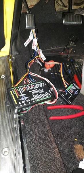

Since my Dakota Digital RTX gauge system has been slightly delayed (about 5 days and it's supposed to be ready to ship) so I still have time. The Wraptor serpentine belt and accessories system and Cold Case radiator is next to go in after a short brakes and front suspension etc "systems check" on the road, and the Vintage Air AC system, then the Dakota Digital gauges will be last.

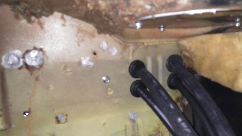

I'm a little confused by that brake line.
Me too. I know he is going to neatly route the brake lines, and I bought an entire kit of stainless steel lines from Inline Tube, and the brakes came with 4 corner line sets, so he has plenty to work with.
Thanks for bringing that to my attention, and I'll follow up.

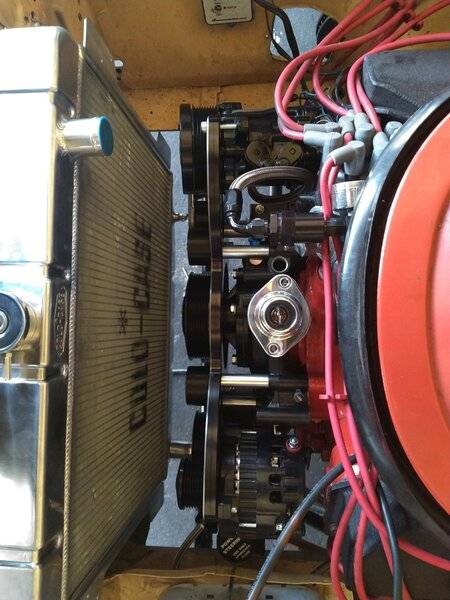

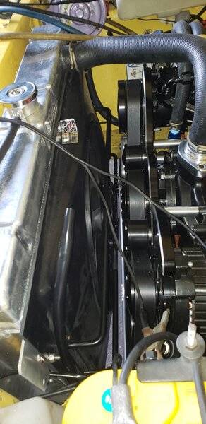

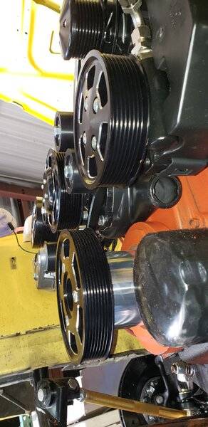

Here's the latest picture. The Vintage Air AC system condenser, dryer, and CVF Wraptor AC compressor are installed. The Cold Case radiator is in.
I chose to delete the passenger side fender access panel bulkhead from the Vintage Air system and got a square bulkhead for the firewall, which will be placed in the area where the factory heater hoses go.

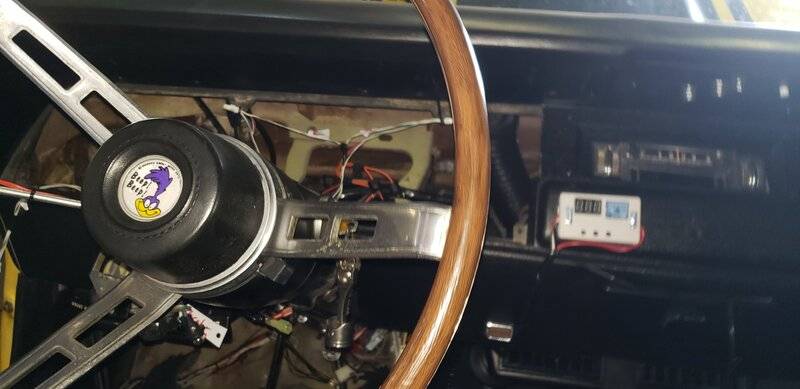

Next up is a single 17" two speed electric fan and shroud assembly, controlled by the Dakota Digital PAC-2800BT Bluetooth programmable module. At 2,600 CFM I'm being assured it will keep my engine cool, including the upcoming 541 stroker, and pull enough air volume for the AC condenser as well.
So the mechanic said he had to wind up using the passenger side front wheelwell access panel, as Vintage Air designates, because my idea of using a 4 port square bulkhead on the firewall by the heater hoses wouldn't work from the perspective of inside the car under the dash...
So he's got the lines run, and he is getting a spiral protective loom for the lines running through the access opening (the one by the UCA) from the hydraulic hose shop next door. He added some insulation to my interior firewall too.

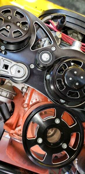

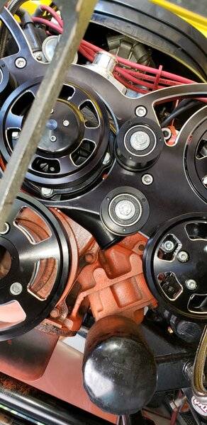

CVF Wraptor serpentine belt and accessories system including: water pump, 140 AMP alternator, power steering pump, and I like the CVF AC compressor WAY better than the Vintage Air, because it works well and actually looks beautiful. Borgeson power steering box, new steering shaft, complete front suspension from QA1 K-member and all other parts except the center link is factory. SPC UCAs for their adjustability. Cold Case radiator. Hydramax hydraulic throwout bearing conversion kit. McLeod RXT 6923-05 dual disk clutch. HitMaster launch control system. Dakota Digital PAC-2800BT electronic fan control module and RTX-68D-CHG-X gauge system. Calvert split mono leaf springs and sliders, Assassin traction bars. Viking triple adjustable Warrior SX "Street Extreme" rear shocks, Strange rear diff cover, chromoly steel driveshaft, front and rear yokes, 1350 solid U-joints. USCT front and rear torque boxes and subframe connectors.

I've been fighting an overheating problem with the GTO for a month, since a different mechanic did some of the same systems installation on my wife's GTO. It overheated on the way home from picking up her "it's ready" car...
I've tried 2 different electric fan and shroud assemblies, but for now, only a mechanical fan keeps it from going over 205. I am as sure as I can be without seeing it, and after CtC I'm going to take off most of the Wraptor components so I can get to the water pump, because I just know that although I told him this was critical, I believe he left the gap too big between the water pump impeller vanes and the divider plate, goofy Pontiac design. 1/10th of an inch is what is required for the pump to operate efficiently. For whatever reason, a mechanical fan keeps the water temperature under 205, but the 2,400 CFM 16" electric fan and shroud assembly did not, but only at 3,500 RPM on the highway, when the fan doesn't really count.
So MY 17" FAN from the same company, was doing GREAT the whole 1 hour 20 minutes ride home! I never saw the temperature go above 193, and was usually 187-193. I was even able to use the "power off fan over XX MPH feature, and set it for 55 MPH, and the cooling system temperature was fine! Anyway, I'm on the creepy pitch black road, and I came to a fast stop from 40, 60, 80 miles an hour so I could "bed" the new 4 wheel 6 piston Wilwood disc brakes.

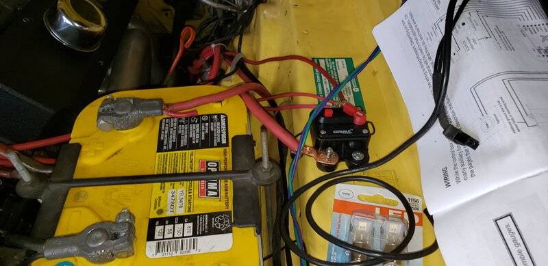

I got about 5 miles from the house and POOF! all the power goes out, ELECTRIC power that is. I checked the 200 AMP circuit breaker in my car and sure enough, it had tripped. I looked and smelled for that distinctive electrical burning smell and I see smoke coming from the fan motor!! The same fan whose praises I was singing earlier this afternoon!!
So what I think happened is despite the 140 AMP alternator, my high beam lights may have caused a current drop and voltage poured in to make up the difference and POOF smoked the motor. The fan manufacturer states a minimum AMP output for the alternator, so it doesn't put out over 14 3/4 volts, for the same reason, voltage trying to trade itself for current just doesn't work well for electronics in general, including these electric fans. I'm going to try to get the manufacturer to overnight one to me tomorrow, and see if I can find out if there's a problem with the wiring or connection point of my headlights or high beams in the near future. Until then, I won't run my highbeams...
