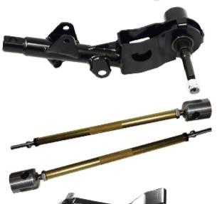

I've owned my QA1 K-member and sway bar...
and complete front suspension system for a year now...
the only non QA1 part being the upper control arms which are these SPC UCAs
I already have 2 way adjustable Viking front shocks.

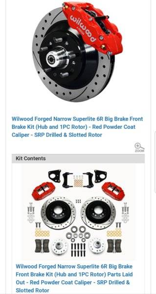

I've been waiting to get it installed until I could take advantage of an at cost deal on a killer Wilwood 4 wheel 6 piston disc brake system, and now I can!
12.88" 6 piston front brakes:
And 12.19" 6 piston rear brakes w/parking brake drum:
Wilwood master cylinder and proportioning valve:
And the 17" Year One aluminum Rallye wheels will allow those beautiful slotted drilled rotors to fit and be seen just fine!
So now little things, like STEERING and STOPPING are going to work WAY better!

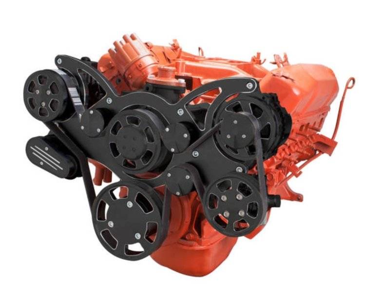

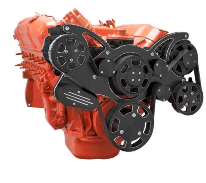

Wraptor serpentine system is in,
The Wraptor is going to get me power steering for the first time, and man, that's going to make parallel parking at 1pm in July in south Louisiana a much nicer, less life threatening prospect, especially with the AC on full blast...

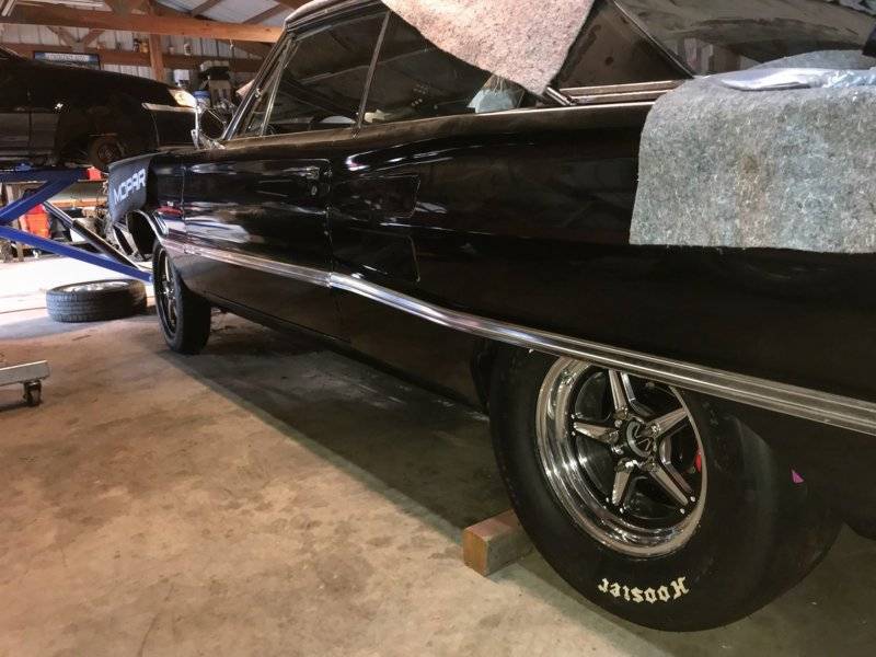

Long time coming!! I would really like to do the front suspension and brakes myself, but "my garage" is still "on the list" and although my buddy has let me use his lift and offered help (when the Saints aren't playing football) I'll be waiting another year to find the time and space at his house. I've swapped out the transmission here on jackstands a couple of times, but stuff like this is better for me to do my job and have a mechanic shop do what they do.

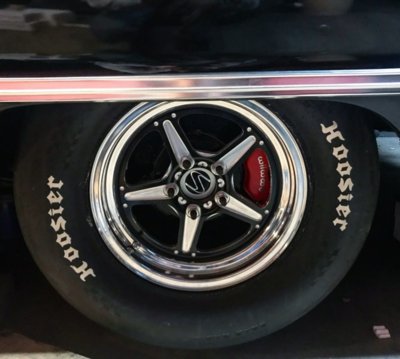

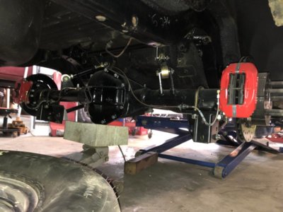

Very nice. Those rears are 4 piston not 6. I have the same ones but opted for no parking brake
I grabbed the picture off the interweb...
MY rear calipers ARE 6 piston...:bananadance::D
I have a manual transmission, so a parking brake seems like a requirement.
Am I missing something?
nope you’ll need it with the manual trans, race car auto trans is why I didn’t opt for that option lol. That ride is going to stop on a dime!

I looked at smaller front and rear Wilwood disc brakes, and because a vendor made an error and is compensating me for labor costs I am going to incur, they are offering Wilwood brakes at cost, so I'm "going for the gusto". Smaller brakes just weren't that much cheaper. I'm keeping the brakes manual because that's what I prefer. This is also along the lines of moving in the "restomod/pro touring" direction I want to take my car in.
No "modern engine" though, ever! This real V-code Roadrunner is ALWAYS going to have a big block wedge and 3x2 of something feeding the beast!!!:bananadance::steering:
