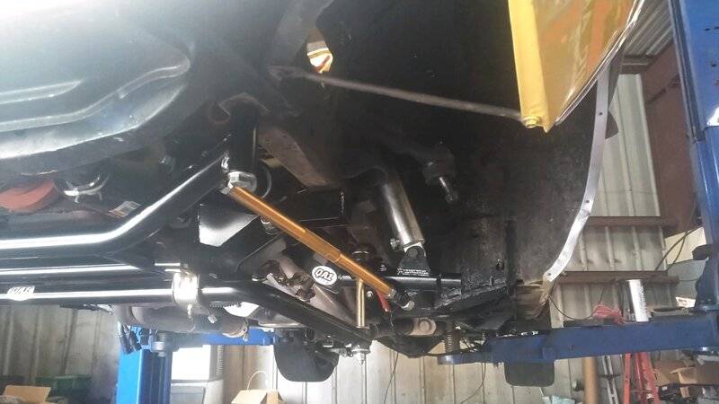

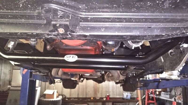

I got pix from the shop owner who is doing the work on my 70 Roadrunner, and his latest area of work is...

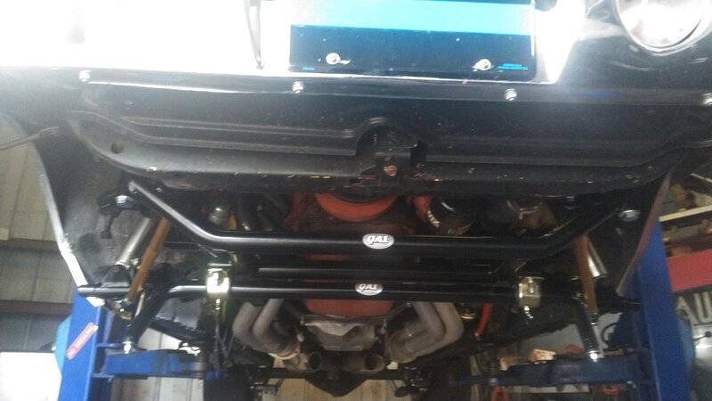

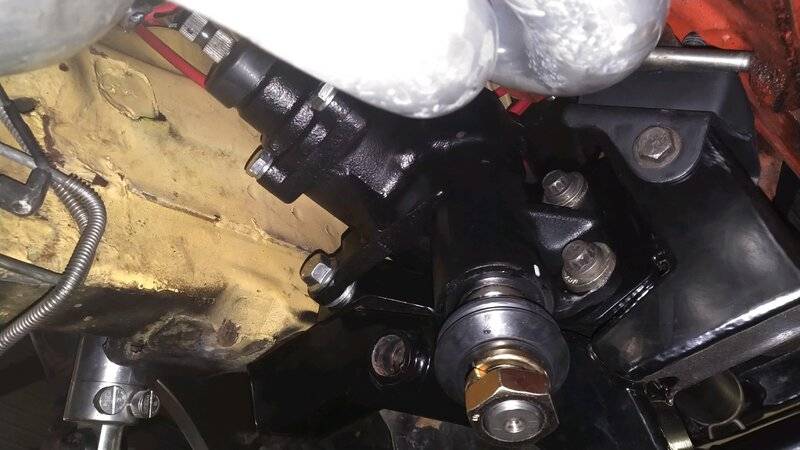

The QA1 K-member and front suspension components!! (all QA1 except for the UCAs which are SPC)
In these pictures I can see the QA1 tubular K-member and Borgeson power steering box, and although I haven't had any problems with my existing motor mounts, I bought a pair of the Mity Mounts that have "travel limiting" bolts inside them, similar to the home made solution that some people have described using.
that is going to be a tight feeling ride
Thanks. I'm not sure if you know, but I have had the USCT subframe connectors, front and rear torque boxes, and front spring hanger reinforcement plates installed, and Calvert split mono leaf springs and triple adjustable Xtreme Street rear Viking shocks installed, and already have double adjustable front Viking shocks.
Did that mainly for drag strip and engine power preparation, but I use my car mostly for cruising.
Thanks. I'll likely try a launch or 3 with the QA1 front sway bar attached, and see if I can hook like that. If I have to disconnect it for the 1320 though, I will. My understanding is the front sway bar prevents lift, and that is detrimental to weight transfer to the rear?
I chose the "more aggressive" Xtreme Street Viking Warrior triple adjustable rear shocks because with the manual transmission and the brutal power output I expect from the 541 stroker that's in the works, I figure I need all of the help and flexibility for chassis tuning I can get WITHOUT going into the weeds, and having so MANY adjustments I'd never figure out the right combination.
If the 541 lifts the front end, I'd expect BOTH tires to lift, vs the driver's side tire only, like on the cars that have body and frame twist. Lifting the tires is cool, but spider webbing the windshield, not so much.

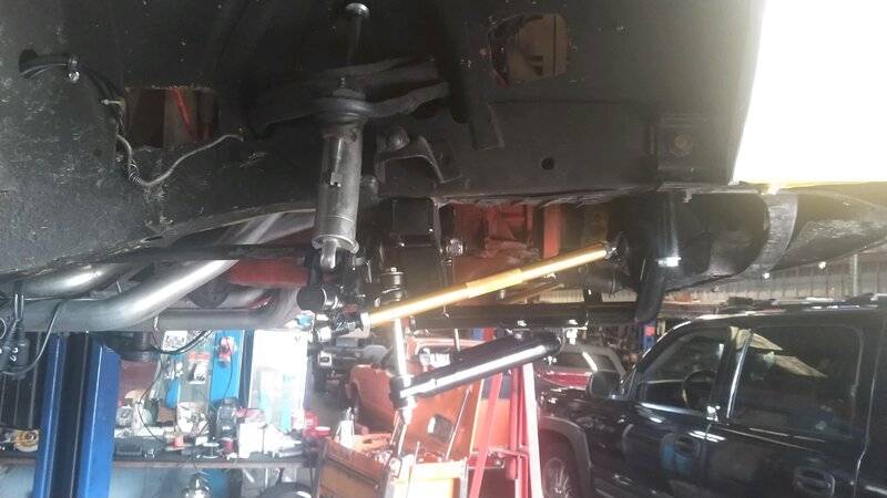

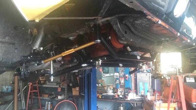

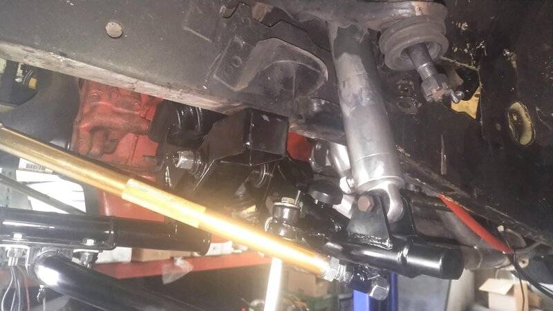

More front suspension parts installed!!
(I'm really getting excited! )
Remember, ALL front suspension components are being replaced (except for the tie rods and steering links) the tie rod sleeves are included as well. The only part that is not QA1 are the SPC upper control arms.
Check out the progress!
More joy and happiness!!
:thumbsup: :bananadance: :bananaweed: :drinks:

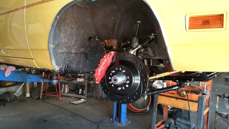

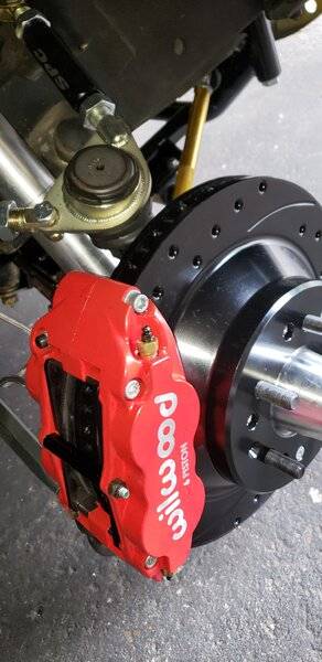

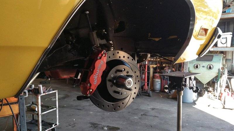

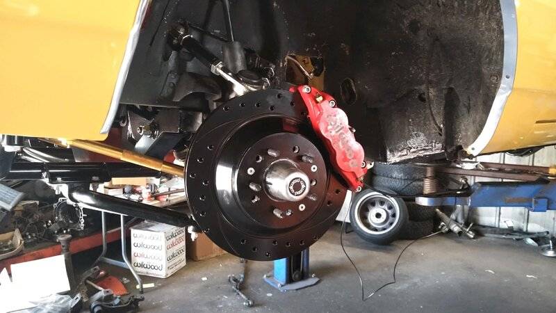

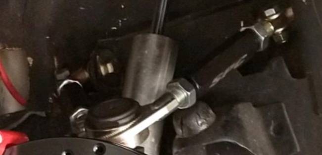

SPC UCAs, stock OEM drum spindles that a :luvplace::lowdown:fellow citizen of the :usflag:Mopar Nation:thumbsup: sent me (my mechanic says they look new) and various other front suspension parts are installed..
Along with my :lowdown:SIX PISTON Wilwood front disc brakes! :bananadance::bananaweed:
(I'm so happy...)

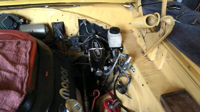

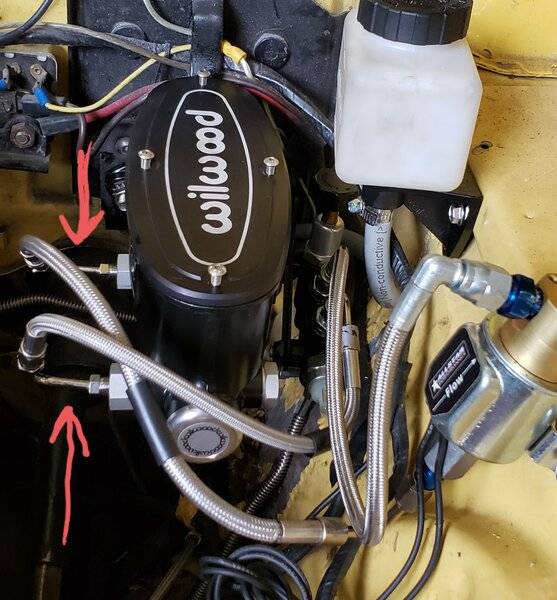

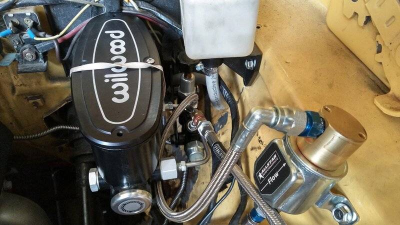

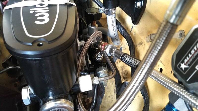

Well, I was reluctant to spend $100 on a billet aluminum hydraulic clutch bearing reservoir, but now that this fine looking Wilwood master cylinder is in place, that white plastic crap has got to go!
Line lock mounted, and adjustable proportioning valve is integrated into the MC plumbing. Satin black billet aluminum hydraulic clutch bearing reservoir is on its way!

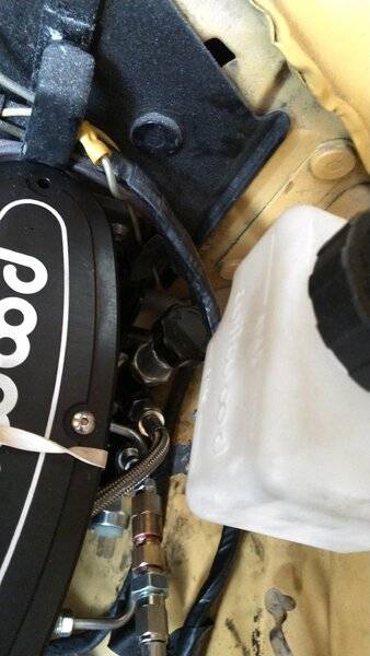

So I went to the shop to bring the black billet aluminum hydraulic throwout bearing reservoir and I get to "check out progress":D

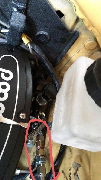

One thing that I'm happy about is the elimination of a "string of adapters".
I had pointed it out when he had sent me pictures, and he didn't "like" it either but said it was a neccessary thing. Well I guess that stuck in his mind because he "discovered" some 90° fittings that allowed for a MUCH cleaner installation of the initial lines coming off of the Wilwood master cylinder.
BEFORE:
AFTER:
:thumbsup:

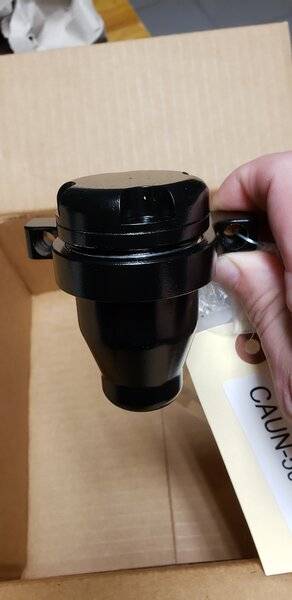

Now the white plastic reservoir will be replaced with this:
AND I won't have an "adapter LOG" either.

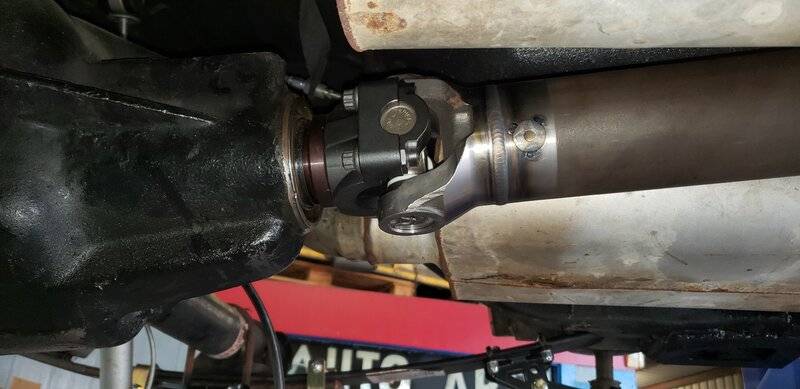

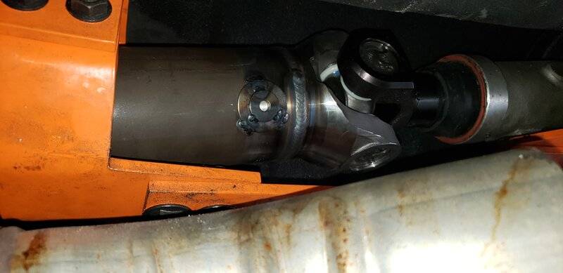

The Strange chromoly driveshaft and slip yoke assembly with the 1350 solid U-joints is in, PLUS he noticed a missing anchor bolt in the 12 o'clock position of the Mancini driveshaft safety loop. He welded a stud to the transmission tunnel and put an 8 point nut on it to hold the loop at that point.
Great attention to detail and not having to be told or asked to fix or improve things that are not part of the primary installation?? YES! THAT is another reason why I like this shop owner to do the work on our classic cars!!
