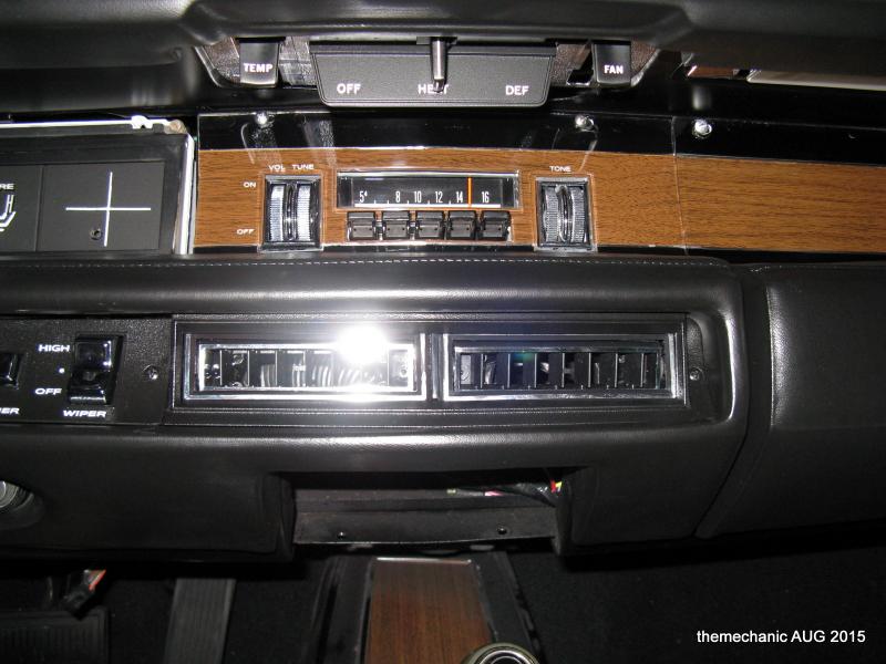

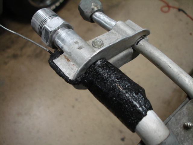

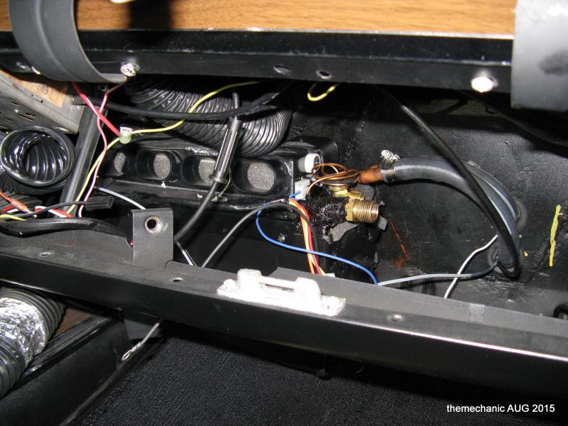

I've had a classic air for 2 years in my 69 RR. Blows cold, even in the desert here, no problems. Recommend highly.

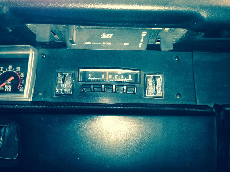

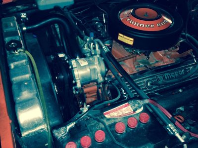

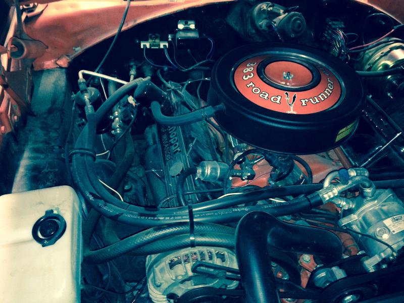

Classic Auto Air Hot Rod System. (Not the Perfect Fit System). Blows cold and uses the factory heater controls. Although, I would prefer the newest Perfect Fit System electronic controls.

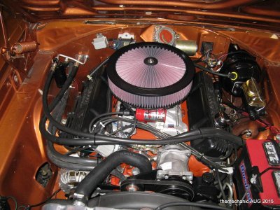

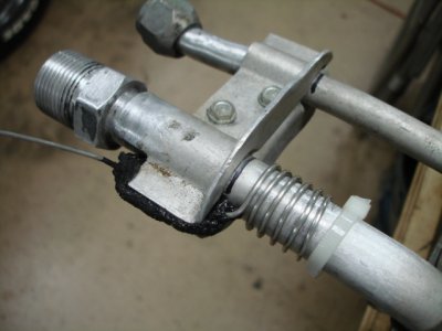

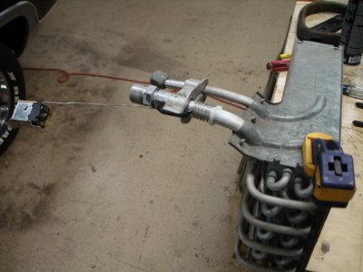

I used a Bouchillon Performance kit on my car. Installation was not too bad, I did take out the evaporator assembly from under the dash to install the clutch cycle switch tubing around the evaporator. I was able to use a portion of the original steel lines to keep it close to original looking. System blows ice cold.
