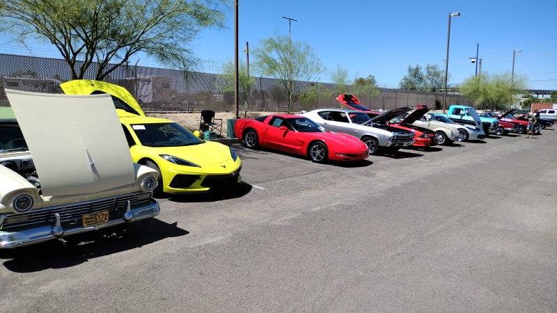

Went to two car shows today. Drove in 103F temperatures and the coronet AC blowing 44.7F out the two center vents. Long traffic lights and the coolant rises to 205, so I shift to neutral at known long traffic lights. Otherwise under 200 coolant temps.
Won 2nd place at a show that had mostly Chevy. Was the only Mopar in attendance. In N Out gift card for $25 and a coffee mug!
Well done! Looks like newer Corvettes were well represented.:realcrazy:
