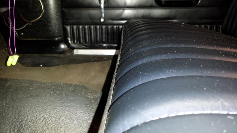

These are pictures of exactly the same covers in different colors.
My white one isn't quite as perfect as the black one. See the bunched up, uneven pleats?

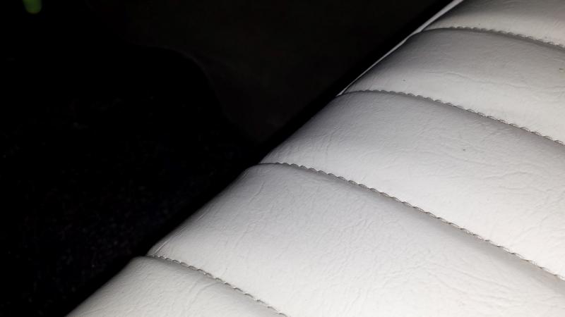

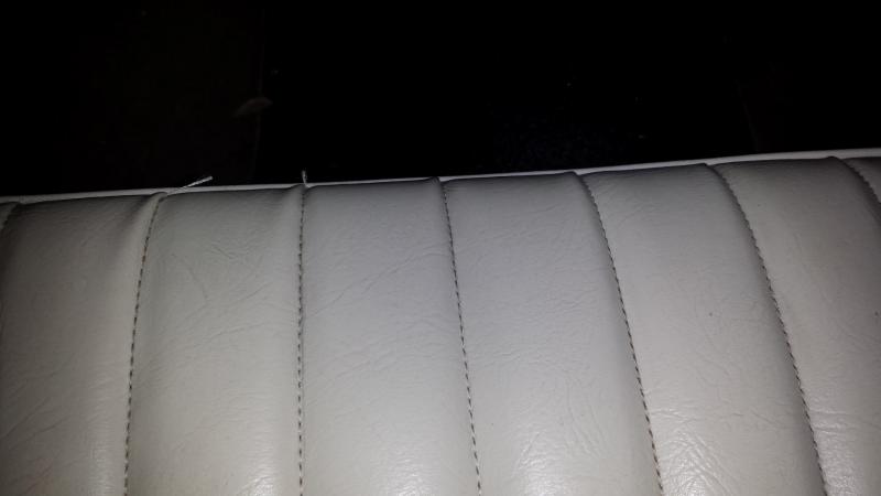

After seeing theses new photos of the seats at a closer view I have to retract my previous comments about the installer,although he should have contacted you first before installing them, and the foam could be some of the issue as far as the bulge on one side.Like I said I worked in furniture for 13 years and after looking at your seat covers they have a bad repeat on the pattern from left to right! Repeat is where the milling of the fabric becomes more or less in one direction on the same roll, and example of this is your distance in between each vertical line changes it might start at 2 3/4 '' and wind up being 3 3/4 as it goes along. When it's sewed there is no way to line the fabric up from top to bottom to match ,an example is the top cover lines up with bottom cover but as it goes along from left to right the repeat changes and the vertical lines become offset. Your installer cannot fix this condition it's impossible.Another indication is on your cover where the line is running under the sew seam at an angle ,its more straight at the bottom and the skews to the left out of line from top to bottom. I know many people here will swear by Legendary products and there is no reason for them not too but this is bad quality period. Now with that being said all manufacturing plants will get some bad products out the door it's just not possible to catch every one shipping out.You need to call them and tell them what is in this post about the repeat on the fabric and the sewing quality. I will be doing my interior and I will be buying from legendary .I can't stress enough to check seat covers for theses types of issues before installing. I think that your installer needs to know more about the way fabric is milled and should have checked the covers before it ever got this far,there is a lot more to doing this type of work then just throwing a cover on a frame.I think they will take care of you on this but your installer needs to suck it up and do the next job free once you get a good set of covers.I hope this helps and good luck,I think a puss is going to slap you right in the mouth next time !!!!

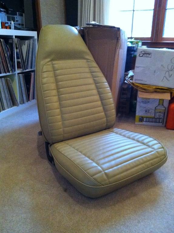

I did a complete restoration on my 70 `cuda seats a few years back. All the metal and springs were stripped/e-coated[replaced where worn out], new burlap, Legendary covers, etc. I took all my new stuff to a VERY reputable interior guy, and received a phone call that I had a problem. It seemed that the covers for the front buckets were sewn too large. I called Legendary about the problem, and they told me that I needed to have purchased their seat-buns to ensure correct fit. I told them that their new seat-buns were already installed, and the covers fit like ****. They called me back to have me send the front covers back. I told them they were a special ordered F8/ragtop set, and I needed all covers to be replaced to insure color match. They said since they were green ragtop stuff, they'd only replace the fronts, and I could purchase a new rear set to ensure color match[that batch of vinyl]. In the meantime, Just Dashes had color matched my new dashpad, and covered/dyed all the interior panels to match a seat swatch. I ended up having the interior guy re-sewing the front covers to fit. Thank God they weren't sewn too small. Sometimes situations with resto's and businesses just sucks.

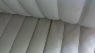

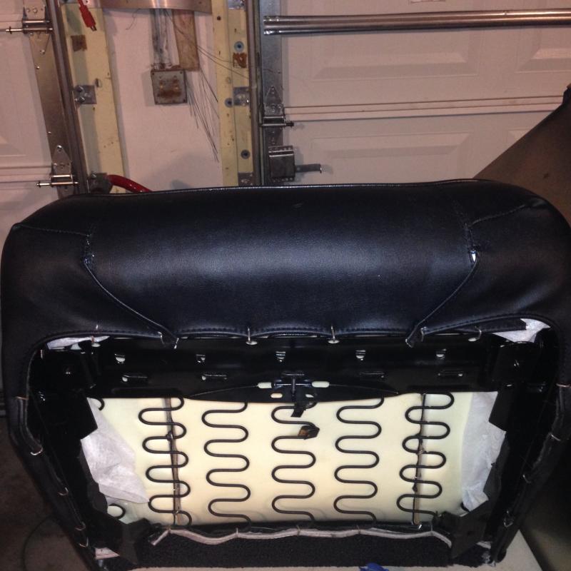

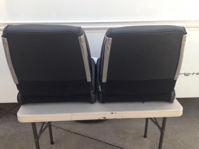

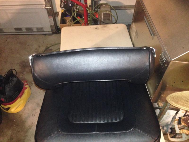

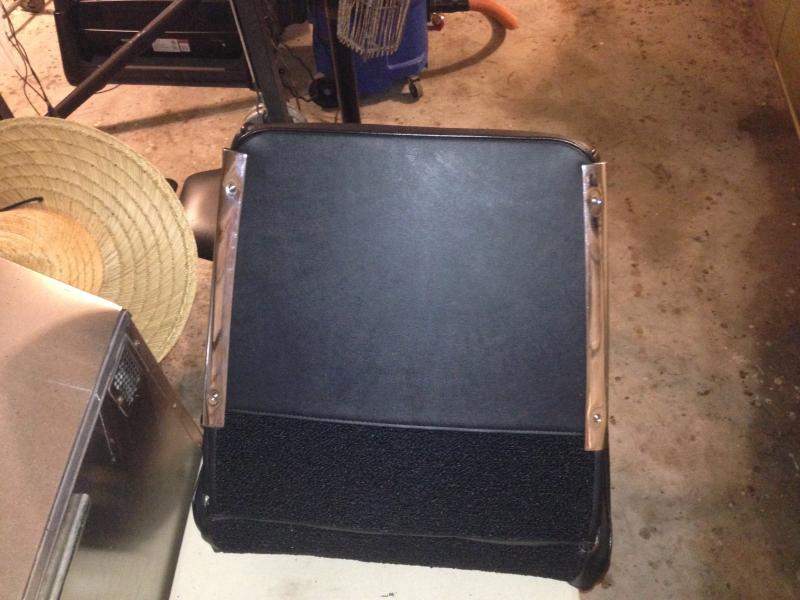

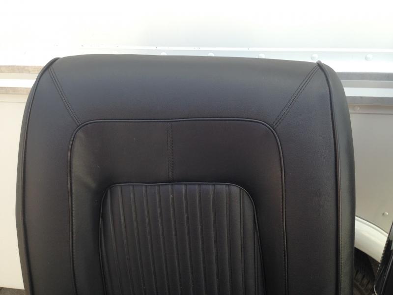

View attachment 221505View attachment 221506View attachment 221503View attachment 221507View attachment 221504View attachment 221496View attachment 221497if it was raining puss i would get hit with the but hole ...first auto interior man asked for money up front stupid me put 500$ in his hand and a month later still not done i confront him and take back my seats and covers and he has spent my 500$ I'm giving him a few days to refund before i hurt him i move on to another shop seats get all redone cost 600$ all is good till i stand back and look i bought thru classic industries there vender is legendary you be the judge I'm fairly certain they will send out new one after seeing what a mess they made and they better pay all cost to remove and reinstall the new ones AM I ASKING TO MUCH ? ANY BODY ELSE HAVE THIS HAPPEN PLEASE ADVISE THANKS..:icon_evil:View attachment 221491 BO

Your seats look just awful. As bad as they look, I cannot believe the installer wouldn't have spotted the problems immediately. I have to say that it is a combo of both bad covers and bad installer. Again though, as bad as the install is, there is no way that those seat covers were made properly. Apparently Legendary has a new guy working there and they are showing him the ropes but they need to QC that crap better before it goes out or their reputation is going to tank quick. I already am likely to use someone else next time.
100% installer, even if the covers were bad he should have never put them on. He must not care about his own reputation, and is just there for the money. Looks like he could give a crap less about his customers.
