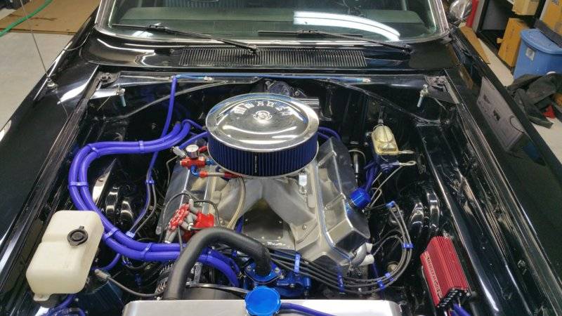

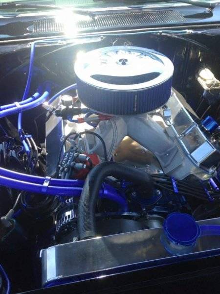

            Here is the orientation I used for mine. I run the line up behind the alternator and to the regulator on the carb using a 90 degree fitting out of the pump and a 45 degree going in. I also have a piece of clear plastic line where the braided hose goes behind the alternator as extra insurance to make sure the braided hose never touches the output post. It really isn't near it, but an ounce of prevention as they say. It has been a great pump. It is easily rebuildable, and the diaphragm is alcohol compatible so ethanol fuel isn't an issue. I did have to massage (read...grind) the one side of the pump a little to clearance it for the block but it wasn't a big deal. Ten minutes with a hand file and a little touch up with some fine grit wet sanding paper and it was all set. I also use one of those Thermotec heat sleeves where it runs down by the torsion bar/headers to keep things a little cooler and fight the vapor lock issues I used to have. Since I put it on, no issues anymore.

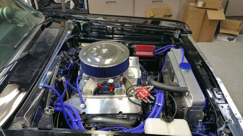

              Unfortunately I have the motor pulled and everything apart right now so I can't get you a better picture. I did go through my old photos and have a few more that may help. Do these make it any easier?

                Thank you very much that helps for me to get an idea how you did yours I've been looking at mine so I'm taking different ideas and going to try to combine them and make it work but I really appreciate you very much
