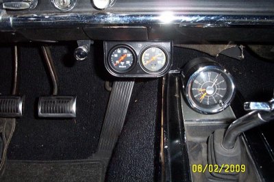

66 & 67 clocks are different, they will not interchange
It's a 66 for sure.I was thinking around $250-300 for a trot line weight.It'll be cool to have just for the looks.I'll post pics of the 66 Charger I've been building for my dad pretty soon.It just looks like a huge unorganized pile of parts right now.
