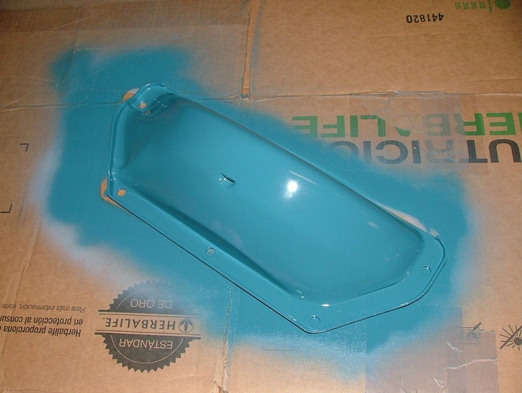

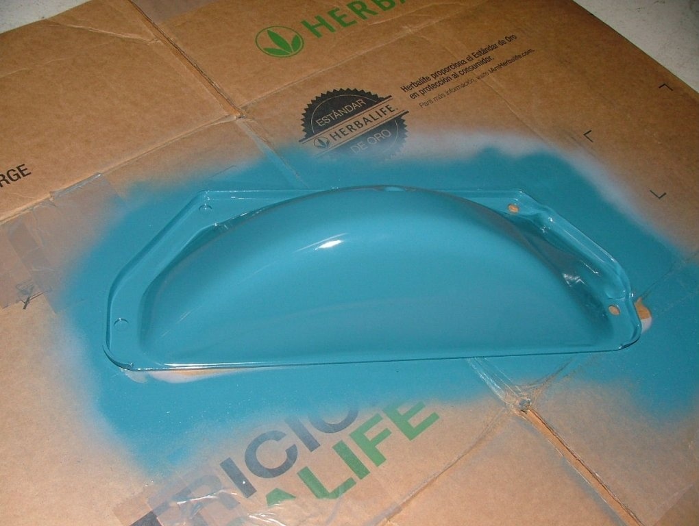

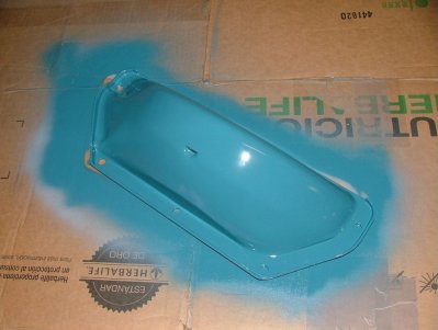

An update on this - I ordered the repro dust cover from Brewer's. It is a very well made part stamped out of heavy 1/8" thick steel. It came unfinished so I gave it a couple coats of turquoise with Dupli-Color engine paint. Going on the car soon.
