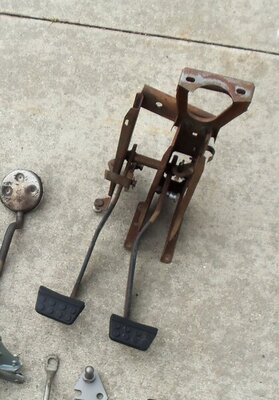

Hey guys...does anyone have a picture of a factory 4 speed clutch pedal assembly with the steering column support attached?... Im doing and auto to manual swap and thought it would just be a matter of swapping over the column support bracket... But not the case.. at least not without mod to factory bracket... Would like to see what the factory looked like... Here is a picture of what I have.

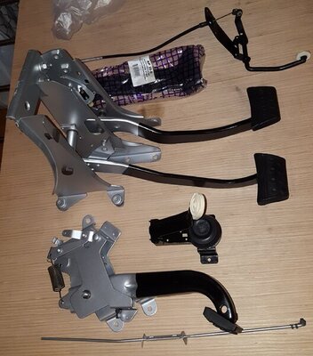

Should have read your post better. Here are a couple more pics of what you were asking for
Thanks guys...looks like there is quite a bit of difference...by the way mine is a 65 Belvedere.
I have yet to install mine, 62 Dart, but I believe there is a slight difference between 62/63 and 64/65.
I think one does not use the bracket as there are two types of brake pedal brackets, one where the top piece turns down, like yours, and one where it turns up, like mine.
I thought the 62/63 didn't need the bracket, but I just measured my 64 which is 15" from the firewall to the column mount, and my 62 which is 17.5.
I kept it and painted it, just not sure if I need it.
I don't have my dash in and everything is apart, but my pedals are done, before with bracket sandwiched between brake and clutch assemblies, and after without it.
Bracket will not bolt on without mods if upper piece turns down.

View attachment 1120861 View attachment 1120862
Thanks..wow you pedal assy look great!!
