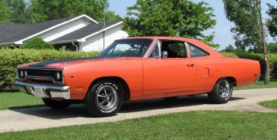

Recently driving my 70RR ,stopped and nailed it from a dead start,speed shifted from 1st to second and clutch pedal stuck to the floor until i let off throttle. new clutch and pressure plate installed when i bought the car. i havent removed the flywheel cover yet,but intend to when weather breaks in tn.
