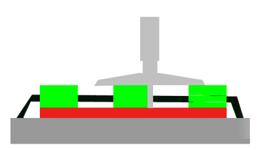

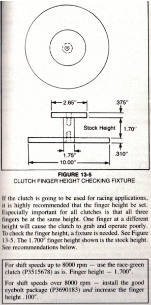

I use a .310" plate and a depth mic to set the 1.700" recommended.........
Thanks, didn't know that. It's back together now with a normal pedal. Anymore trouble and I will look at this first
Is there any specific reason for the 1.700 height or just a reference? My clutch is a hays brand not stock and I don't know the nominal height is. I made sure all fingers were equal before assembly my question is as long as fingers are same height and thrust brg contacts them at same time, the Z bar is only going to move so far ,as long as fingers are not lower than the 1.7 shouldn't be any problem....right? Same amount of movement, different height ?
If one came loose on you and backed off the peens on it must have failed. I believe the 1.700" recommended finger height assures release of the disc with stock components. This is from way back, it's nothing new. Contacting all three fingers at the same time at 1.700" is their goal. A few either way won't hurt as long as they are even and the plate engages the disc evenly.
FWIW, A new 3100# pressure plate I bought from Mopar had one finger .050" out. The other two were spot on as assembled.

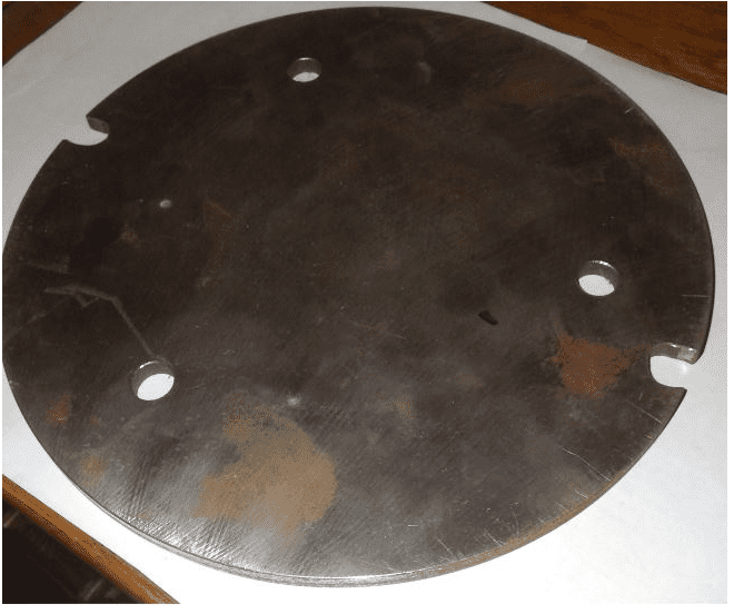

Here's the plate I had ground to .310" (from a 500 ton press ram spacer). It's just gets held in place of the disc between the PP and FW when bolted together. Several lengths of 5/16" key stock positioned right might do the job as well.

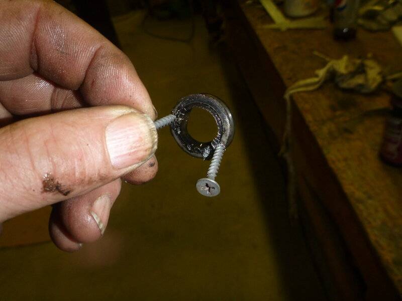

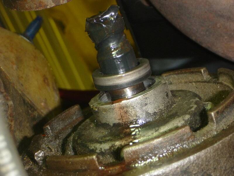

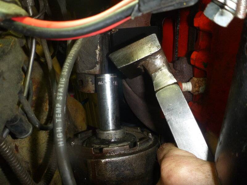

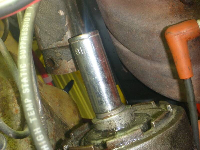

Leaking from where? Input shaft or output? Both seals are easily changed IN the car without the need for any special tools!
Here's how to do the input seal.
The output seal you use the pump pressure to blow it out by turning the wheel fully to the stop.
That genius! Both shafts are leaking,runs reservoir dry in 70 miles. What holds bottom seal in? Just take off pittman and crank wheel and hold it there? Probably will remove box, want to look at the return fluid line inlet. Isn't there a spring and check ball underneath? Wouldn't have to do this now if I had done it at time of c/o from manual. Should be able to pull bottom seal the way top is pulled?
I believe there's a retaining clip on the output shaft seal, I haven't done that one but I know @Richard Cranium has... but yes Pitman arm off, crank the wheel to the stop and pressure pushes the seal out.
Yes, I replaced it last year & it wasn't that bad of a job at all. After you remove the pitman arm & pop out the lower seal, there is a snap ring that holds the upper seal in place. Remove that snap ring, start the car up and turn the steering wheel hard to the stop and this action blows the upper seal out. Be sure to have a catch bucket underneath when you do it. Put it all back together & you're ready to go.

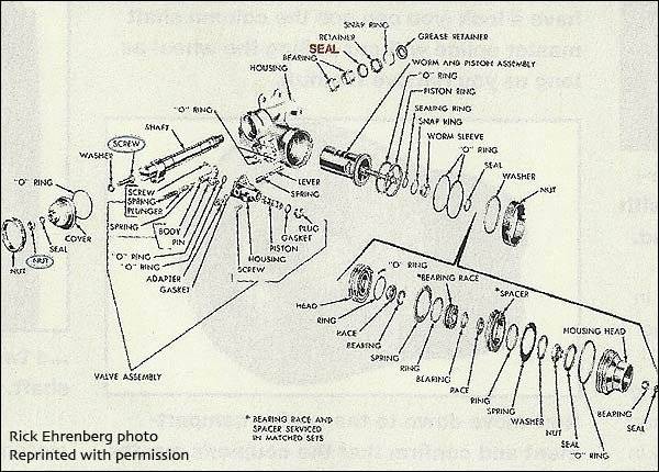

Is there any thing else that comes out with the upper- lower seal? Don't need any surprises.
Thanks for the diagram, unit is on the bench. Now the fun begins, maybe.
