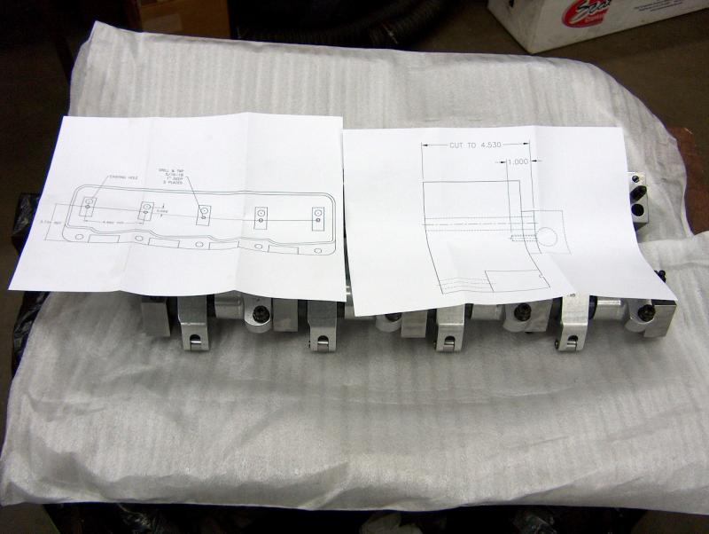

Yes we had diamond make the pistons from the chamber mold we sent them. Also worked with them to lighten them by taking out extra material. If anyone wanted a set I could put you in touch with my builder to get a set based on your needs. The rockers are T&D 1.6 you have to cut down the rocker shaft stands to mount them. My heads are off to the machine shop today to get that process started.
Install for T&D

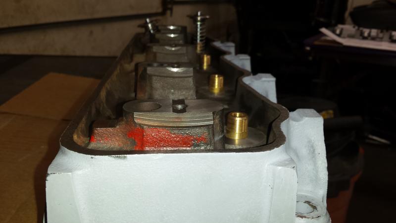

Stands cut for the T&D setup.

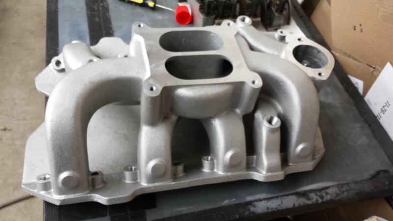

someone did some measurements on their 66 charger and should fit with a drop base filter. I will be using a wo23 scoop from AAR which is also the 1" taller version so I should have room.

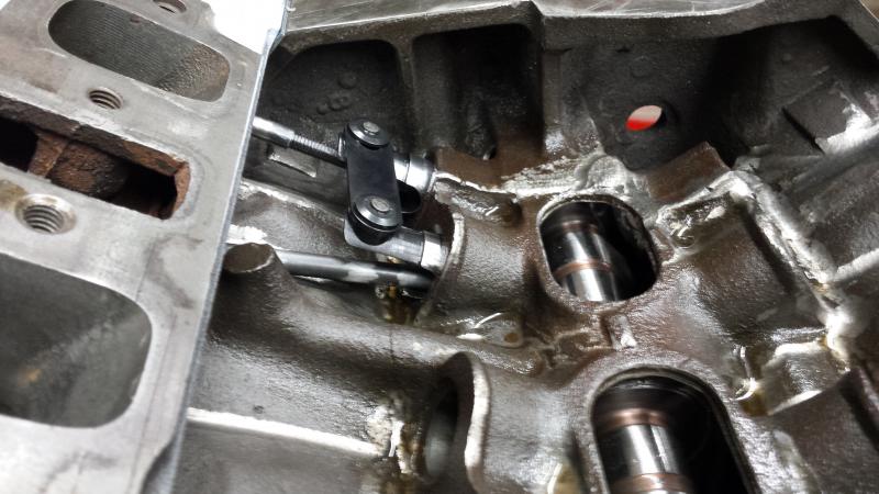

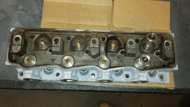

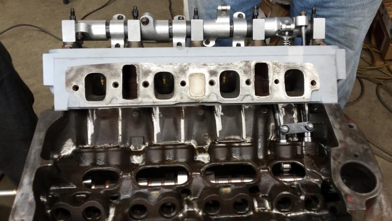

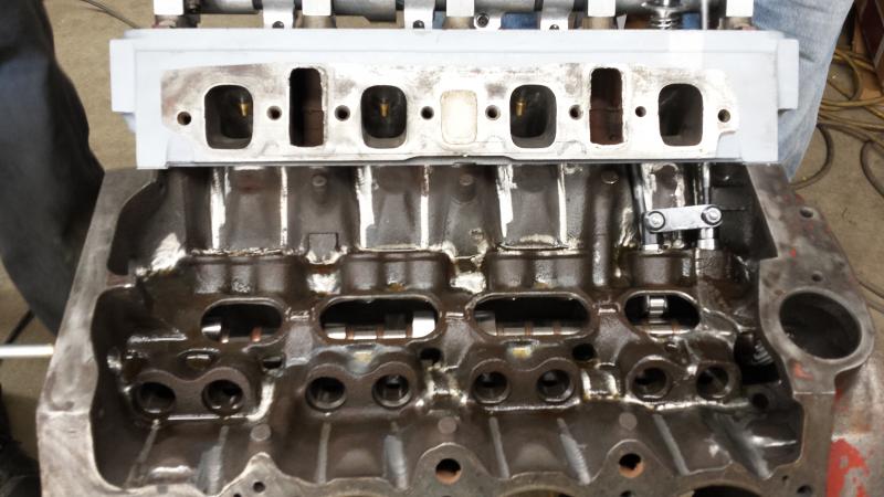

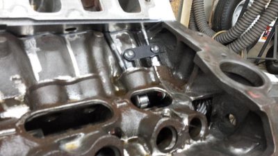

Some grinding on the block and heads along with a special intake cup offset and the lifters fit with the 1.6 ratio.

Are those T&D rockers made specifically for the Poly or are they adapted from another engine(s) ??
Thanks. Couldn't read it.
Was it difficult to get the rockers done/made.
Is it possible I can get a part number?
The part number is not in any of their catalogs so its best just to call them direct. Don't go 1.6 unless you are will to do special lifters and grinding. Takes them 2 to 6 weeks to make them up depending how busy they are.
