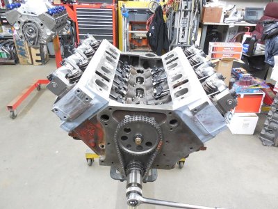

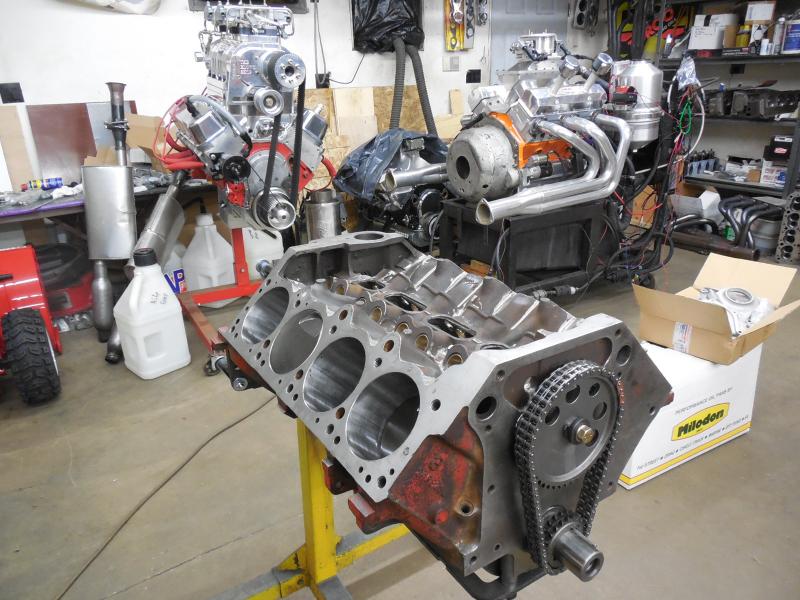

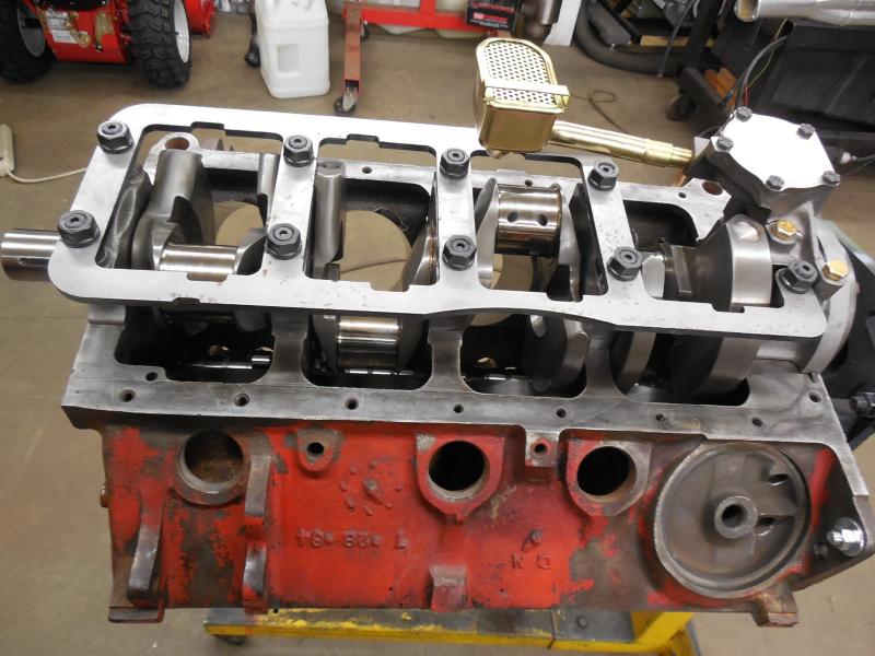

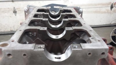

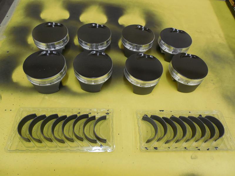

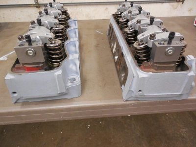

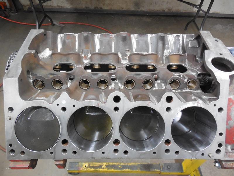

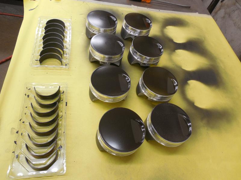

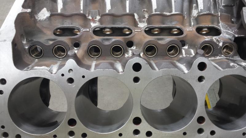

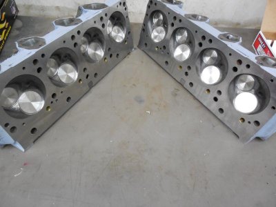

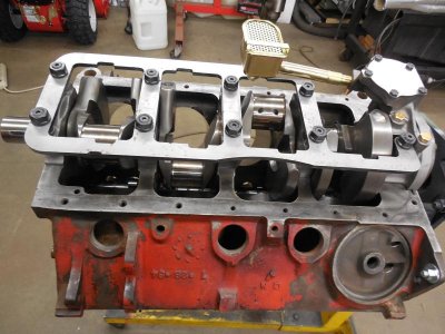

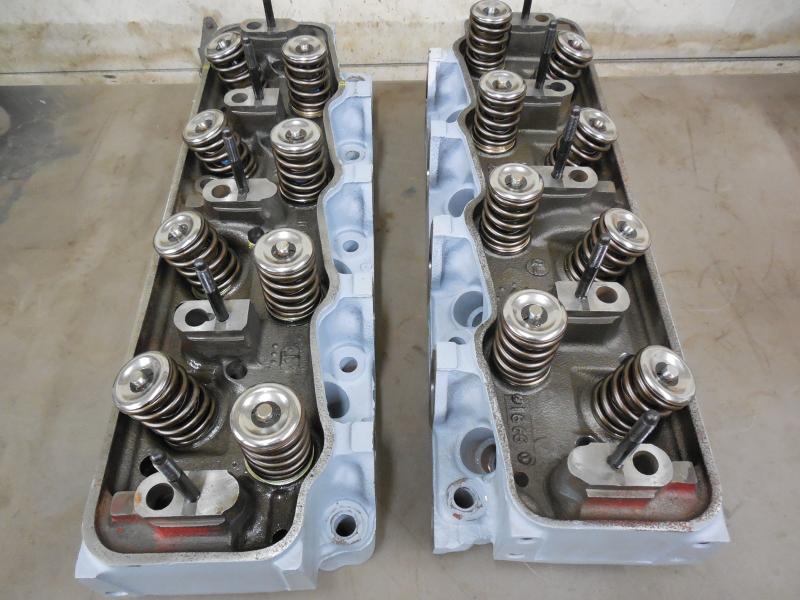

block back from machine shop

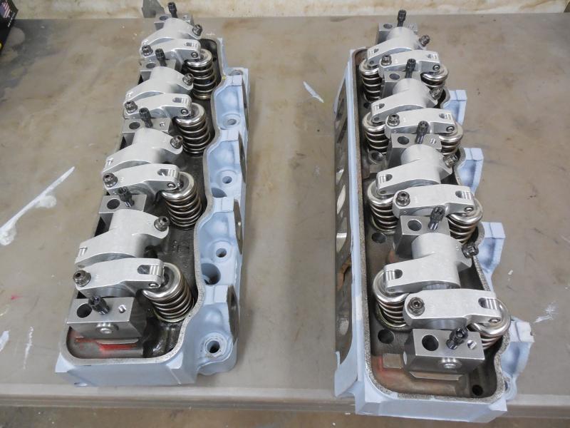

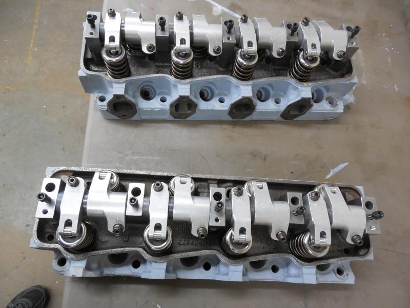

friction and thermal coatings complete

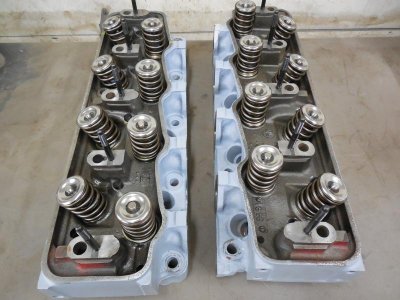

heads assembled

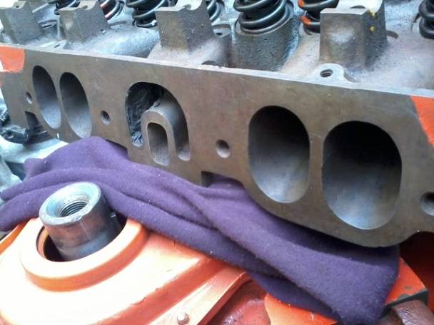

I have here a set of (iron)Ovalport Mopar Bigblock heads from the famous Weslake Engineering UK shop to copy.
Shame they never made it into production like the infamous W2/W5's did?
Best wishes from John Hatchard England
what did you do to detail the valves and what shape, tulip, nail head etc
did you try 30 degree intake seat? (for engine masters type build)?
