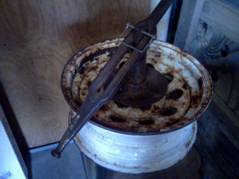

Thought I'd share this.
I can't believe the company never thought of this.
After it almost got me the other day, I decided it was time to put a plan in place that I'd been kicking around in the back of my head....
It's a simple 1/4 hitch pin through a hole I drilled about 1/2" down on the main rotating shaft.
It keeps the bar in place so you don't have to hold it, thereby eliminating the chance of the bar kicking back or jumping forward while you're keeping it engaged on the bead.
Seems to work just fine.

I have a Coats tire changer. Great idea!
That is a good plan for someone that only uses it at home but will slow you down in a busy tire shop
but the new styles are safer
