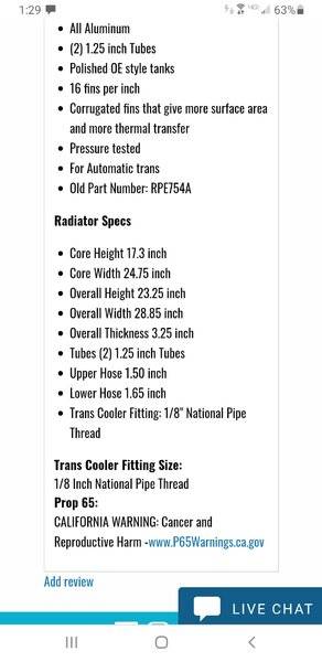

Here are the dimensions from the Cold Case website. It clearly shows the overall thickness is 3.25"
Yes, they did "just" fix it. When I had the conversation w them earlier it still showed 3" as the Summit ad above shows.
Someone or multiple people gave you bad service. We should be paying for the return if you purchased the radiator directly from Cold Case and not a dealer.
Also, I'm sorry the listing was incorrect. I believe the actual core measurement is correct. Sometimes the side panel structure or tanks can cause clearance issues. But we will update our listing.
