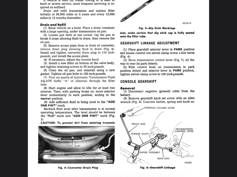

My front shift rod came off the steering column. I thinking all I lost was a bushing and spring clip with a washer.
Anyone have a parts diagram I can't believe im having such a hard time finding one
Oh its a 69 corner R/T
Go to mymopar.com they have the service manual free download it will have what your looking for
Here’s a snap shot of the linkage
Ya right there in the column mine came apart kinda hard to see what I'm missing
if you get the manual read through the steps to disconnect it I believe it gives a description of what’s there
