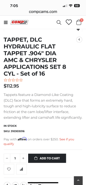

I see Comp Cams have the DLC lifters in stock for our engines. Has anyone tried them yet? I used a set in a small block Chevy I built for a buddy last year, no issues after 2500 miles.
Those “ Diamond Like Carbon “ are slicker than you know what. !
AND
Having that DLC coating IMO will help them last a long time !!

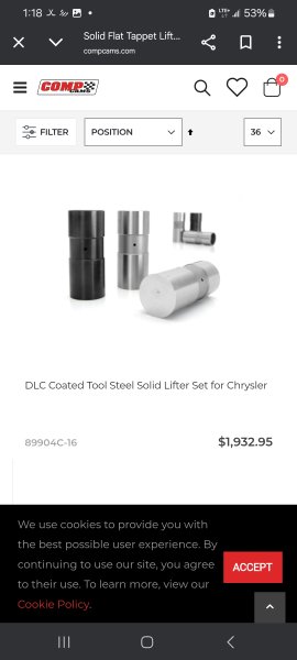

The lifters in post #9 are sol, not Hyd...also have a Chebby look about them...
