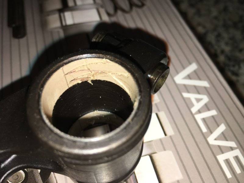

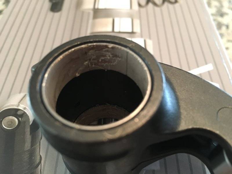

I recently purchased a set of comp 1621-16 ultra pro magnum rocker arms, and I have a question about the bushings that are installed in the rockers. While inspecting them, the bushings appear to be covered in some sort of paper material that is peeling off in spots on some of the rockers. I'm assuming that this material gets removed before installation? If so, how do I do it without damaging the bushing because it does not come off easily. There is no mention of this in the instructions.

Drop them in a can of NAPTHA
Correct! Clean all parts before installing, period.
Ok, il clean them. I just wanted to be sure that I should remove that coating. The guy at comp cams that I called wasnt sure if I should remove it or not.
Goes to show you the people on the other end of the phone line hardly have a clue. Happens way too often.
Just got a call back from comp cams warranty department. They said that is a teflon coating and shouldnt be removed. Looks like i will be sending them back.
This is what I was kinda thinking (I.e. not good) and sad to see it.

Yeah, thats what i was expecting to see. Hopefully the new ones arrive in better shape.

Yeah im not sure why they advertise these as being roller rockers when they come with bushings.
That’s a scratch on the surface of the bearing from someone wiggling it back and forth over a burr on the shaft.
