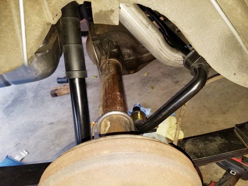

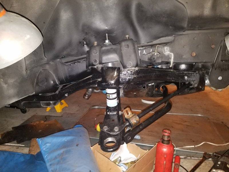

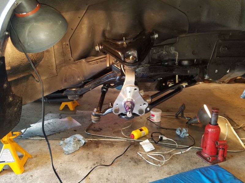

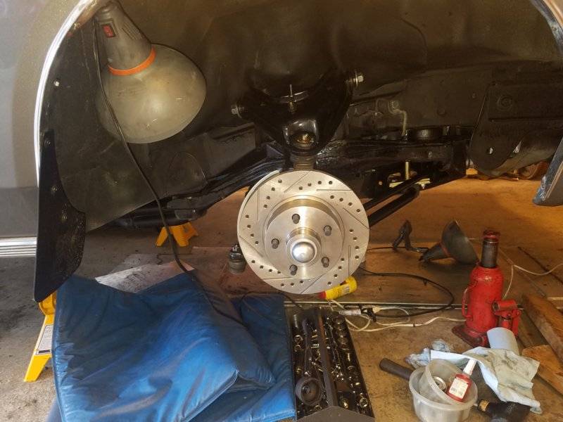

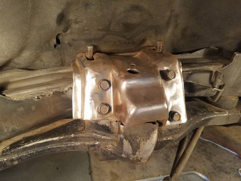

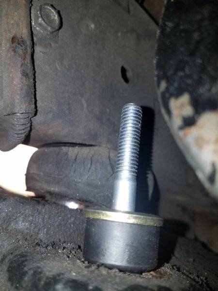

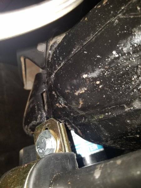

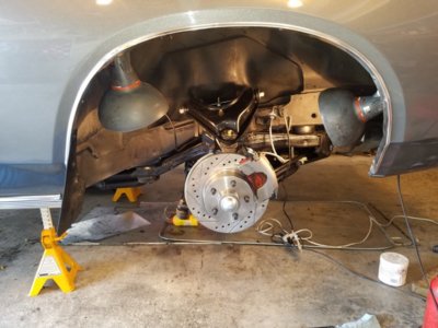

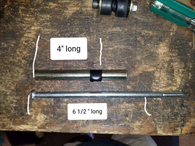

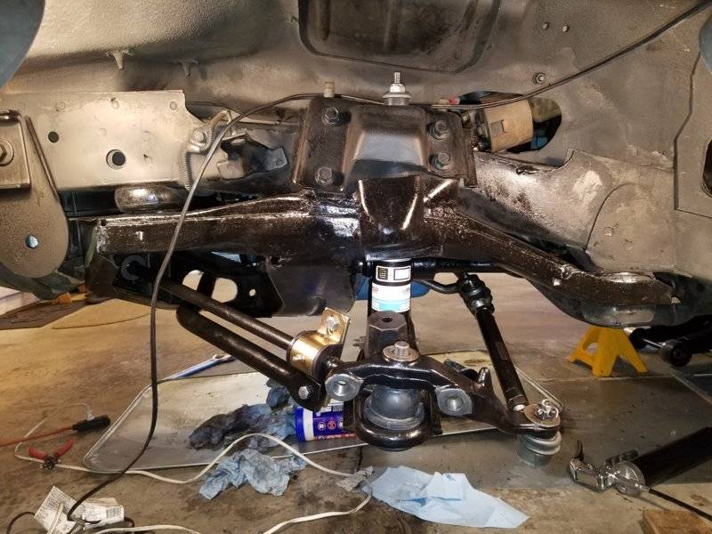

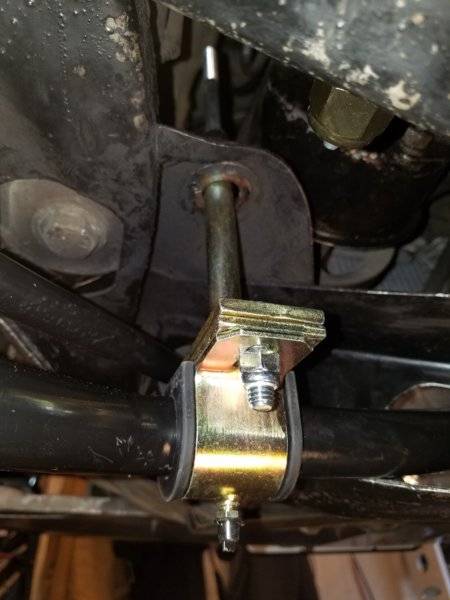

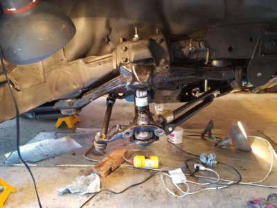

I started on the passenger side I was able to install the torsion bar, lower control arm, strut rod, and the Bilstien shock. My measurements were NOT accurate enough that I sent to PST I was off by and inch on the spacer I said 4" it was 3" and the bolt which I said was 7" was 6" so I just cut the spacer and bought the right length bolt.
