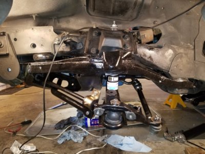

Complete front suspension rebuild and some rear also.
Firm Feel sway? It looks like it and I have theirs on my car
It was a bungee cord to hold up the end of the control arm so I could set up every thing to press it down. It worked great
Yeah, not real easy to set up a control arm in a press, hold it in place and then grab the handle on the bottle jack. Having a motorized press pump and a foot switch would be real handy doing this stuff.
No PST with my discount belonging to this forum great deal . I bought a rear sway bar also.
I bought a press at Harbor freight it actually worked real well for doing this kind of job it was actually fun doing this it wasn't as hard as every one says it is .

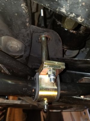

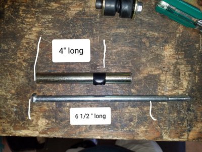

Installed left torsion bar,lower ball joint, lower control arm, tie rod to knuckle and Bilstien front shock. I didn't get to finish the PST sway bar they sent me to long of a bolt and spacer so I made measurements and emailed them what I need. So and FYI if you order a front sway bar from PST for a 1973-74 Dodge Charger you might want to call them about there mid section sway bar kit.

I didn't get to finish the PST sway bar they sent me to long of a bolt and spacer so I made measurements and emailed them what I need...
Yeah, same issue here, do you mind sharing your measurements? they had me send them a bunch of pictures, bolts and shaft way too long...
The pictures are above unless your asking for something different.

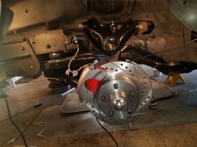

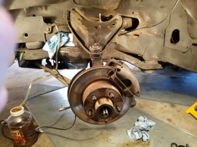

I was able to get some more parts installed today on the driver's side I'm almost done with this side then start on the passenger side the spindle, dust shield, and rotor . The comparison from start to finish is really remarkable looking you always picture it in your head but in person it looks even cooler.

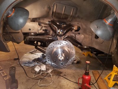

In keeping with the thread title.....Here is some rear for you Doug:
The drivers side is complete now onto the passenger side.

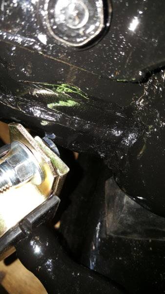

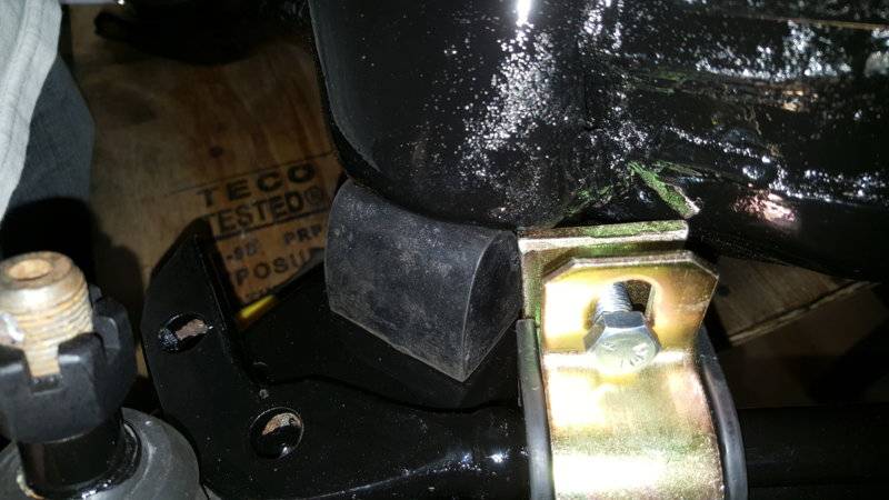

Hey Doug, on the PST Swaybar, have you noticed how the bracket that attaches the swaybar to the strut arm hits the k-frame when you push the LCA all the way up until the bump stop makes contact with the k-frame? I am having that issue, will look at it closer today, was wondering if yours was doing the same and if you had to modify it... I even tried reversing the bolts... too close / hits.

I just got mine and they are still too long... i can flip the swaybar with the bow towards the bottom which works but makes the swaybar hit the kframe... the other way it doesn't work, the spacer and bolt are too long... which doesn't really matter i can cut it down and buy a new bolt... but still... i have a lot of concerns it should just fit correctly... debating on returning mine or sticking it out and working with them. At the very least i can say they do listen and work with their customers.

I have a few questions to the issue that you are seeing with the clearance to the k-member prior to the bump stop making contact. I would like to know is the suspension loaded at the time of the picture? Has ride height been set? I am having a little difficulty with orientation. Are the torsion bars installed. From the pictures Hijinx provided it looks as though the k member is out of the car and the suspension is not fully in place. This could be adding to the issue with proper clearance.
