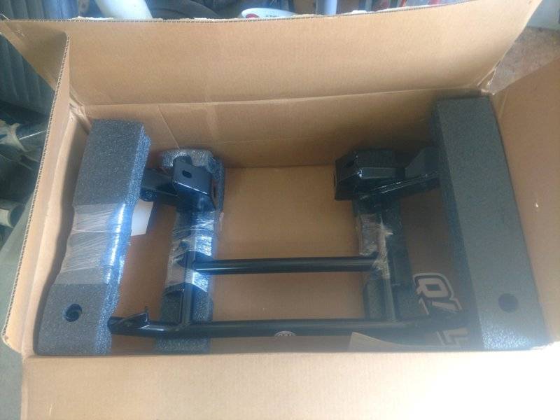

Complete new front suspension DELIVERED. QA1 everything w/SPC UCAs Advice? Tips?
You know the tire size? And you want the fender lip about 1-2 inches higher or lower, so you add or subtract and measure from the center of the spindle to the lip. Jack the lca up to get you where you need to be, now install the tb. This will get you really close to where you want, now dial it in with the adjuster bolt.
This came in already! The rest is all due Monday!

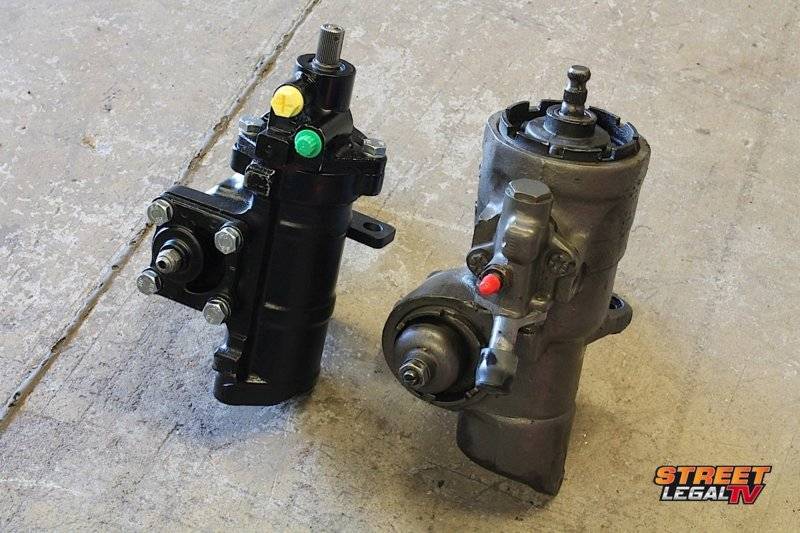

Well I always thought you had to have power steering for that, BUT:
"This new unit from Borgeson will work for both manual and power steering cars."

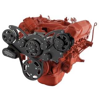

https://www.cvfracing.com/black-dia...ig-block-mopar-alternator-only-all-inclusive/
I will eventually add their Air Conditioning unit too.
The Borgeson steering box looks GREAT!
(On the left, for those who didn't know, like me)
