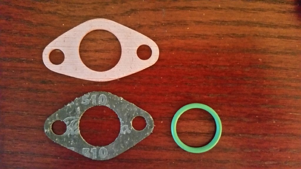

Hello
I am restoring my AC system and the oval fittings that connect to the compressor seem to require an o RIng to fit in an indented space. Can any r134 o ring work or does it need to be a special one?
Thanks
Dane
you are talking about the high pressure and low pressure fittings on the compressor. Yes, 134 o ring should work, but you also need gaskets for both of those connections and by the way the gaskets are not identical, notice the difference in the picture. Also don't forget the epr valve should be removed and a secondary temp switch should be installed on the evaporator side of the compressor.

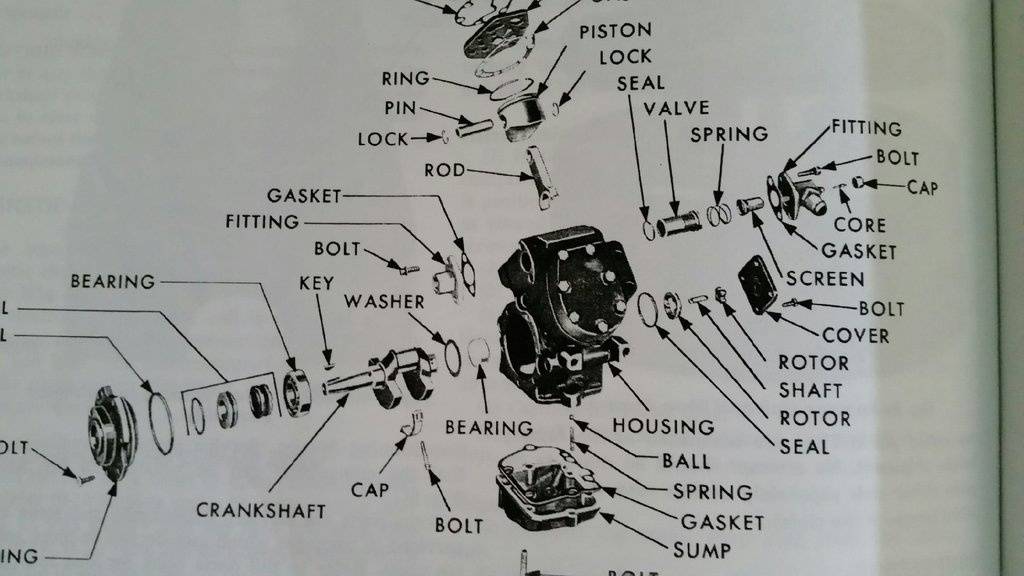

The side with the large "O" ring doesn't require and gasket. Look in your service manual only "O" ring pictured.
Ron
I don't speak 1973 I was referring to my 1972 which only uses O-ring per the FSM. I don't believe the OP said what year he was working on though now that I think about it.
Ron
