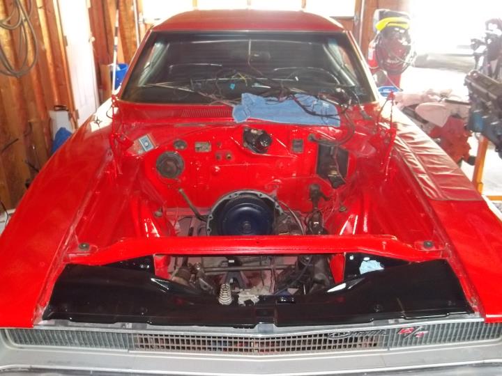

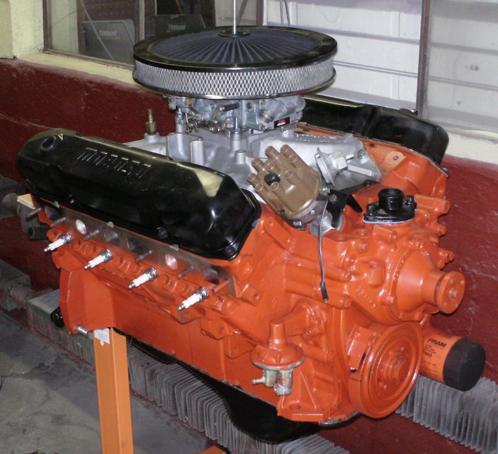

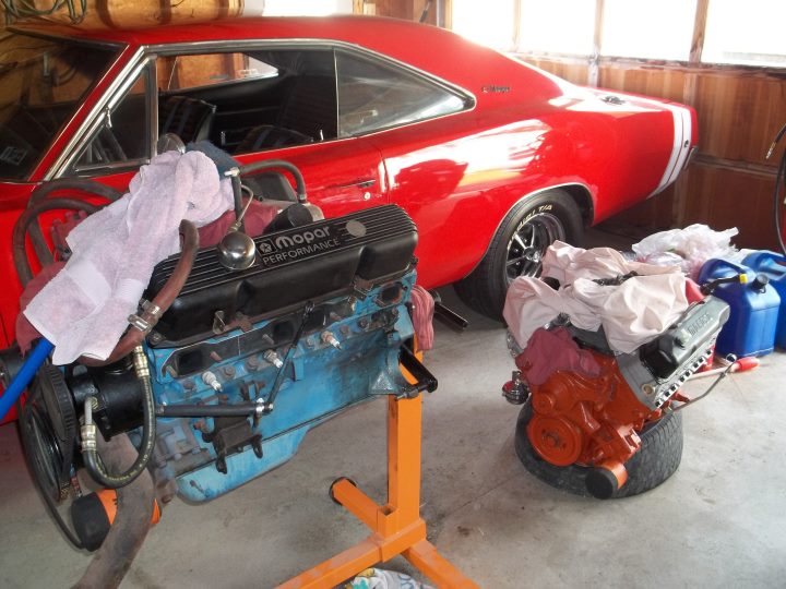

Here are some pics of my project so far. The new engine is in the car now. Just tying up some loose ends. Picture #2 shows the old 383 on the stand and the new 440 to the right. Picture #3 shows the engine as I bought it before I started rebuilding it to race.
440 .30 over, Stealth CNC machined heads, Comp Extreme .545 Cam, Compression 10.2:1, Performer RPM intake, 800 Edelbrock Carb, Hughes 3500 Stall converter, 4:10 Richmonds gears. I am aiming for low 12's to high 11's.

very nice 68.real rt?i am a bit envious,68 charger is my fav car.sadly also first year for smog requirements here in vegas,thats why i am building a 67 coronet.
Thanks, No not a real R/T. This was my first car I ever bought and at the time could not afford a real R/T. I want an R/T but don't want to part with the car. Too much sentimental value.
